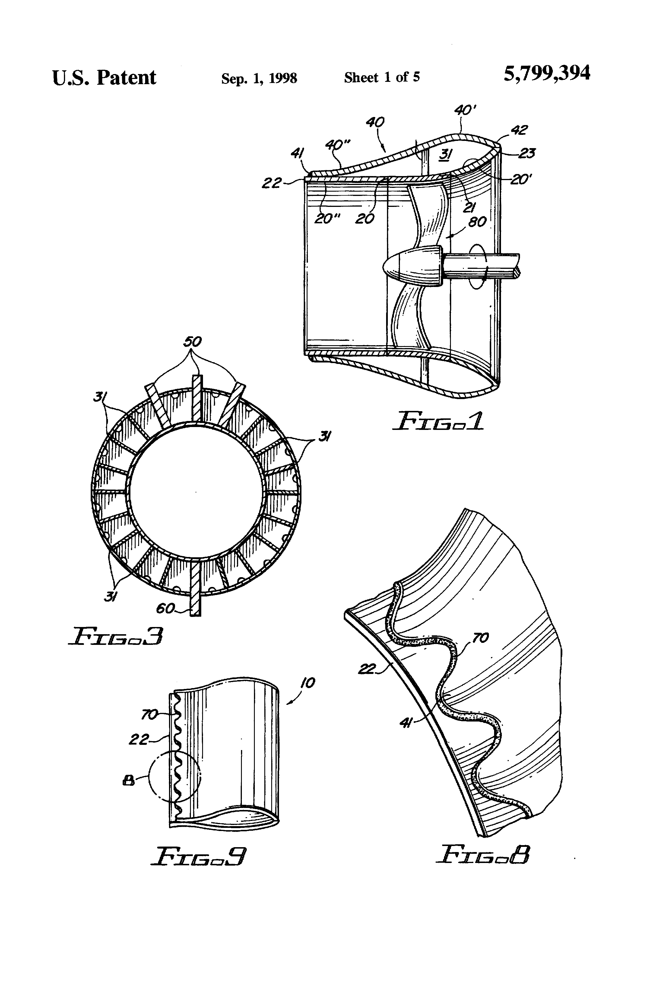

Re: Kort nozzles
Posted: Aug 14th, 2014, 9:40 am
by scubersteve
actually you can just look up their patent and see their drawings on Google patents...
since it is a design patent drawing it has to be more than representative...
https://www.google.com/patents/US579939 ... CBwQ6AEwAA
rice nozzle.png (78.34 KiB) Viewed 15439 times
Re: Kort nozzles
Posted: Aug 14th, 2014, 9:57 am
by scubersteve
Then again, if you look here...
http://archives.marinetech.org/rov_comp ... Report.pdf
in the propulsion paragraph, they have a solidworks profile of the "rice" nozzle they used and the corresponding test results which were pretty good.
