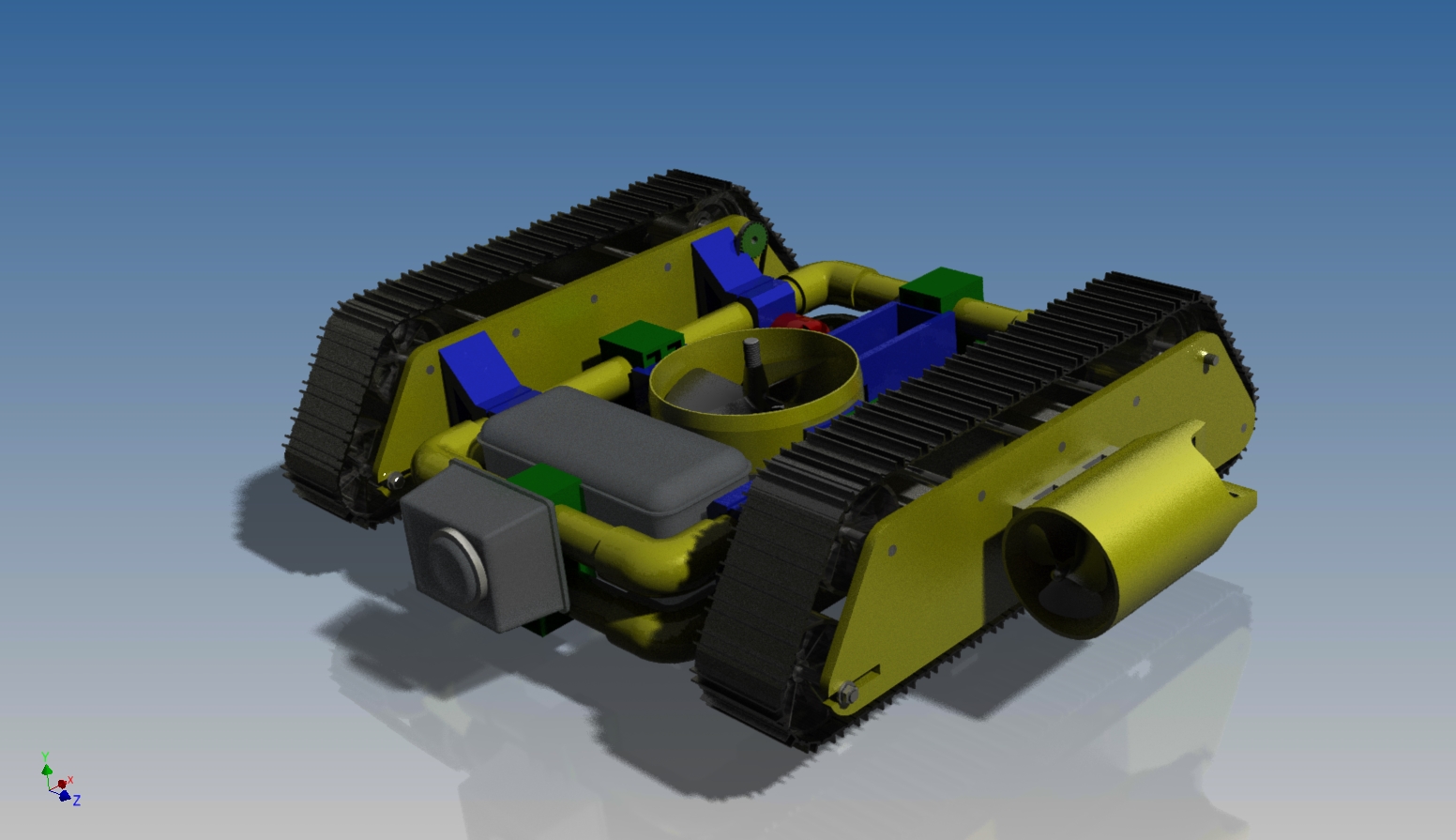

Posted: Feb 1st, 2014, 12:29 pm
by ScottishTom
Sorry for taking so long to reply to everyone, with the Christmas period and other Uni commitments this was put a bit on the back burner although it is in full force now!
m_g I have already drooled all over my laptop looking at the stuff that seabotix have, their ROV's are absolutely amazing, if mine is a hundredth of one of theirs I will be very happy!
Mike I will get in contact with you shortly about the program, I am still at the stage of making rookie errors and buying the wrong ESC's (they didn't have a reverse function). Seems living in Britain we don't quite have the same resources for buying R/C boat and submarine components.
The Digit ROV Suite looks ideal, my project aims to create a hull crawling vehicle therefore creating my own programs is not as important. I have had almost all my components 3D printed now, motors are bought just need to get my head around the wiring of it. I have no idea if a 12v battery will be enough to be honest, just fingers crossed it will, all the motors are fairly small because they are brushless outrunner motors for model aircraft.
I have already worked on a hull crawler that uses magnets and wasn't overly impressed hence the use of vertical thrusters.
Ill please see below my update CAD drawings.
Hull Crawling Vehicle Assembly 2.jpg (433.54 KiB) Viewed 18630 times
Cheers for all the input again guys, still very very new to all this!
Tom
