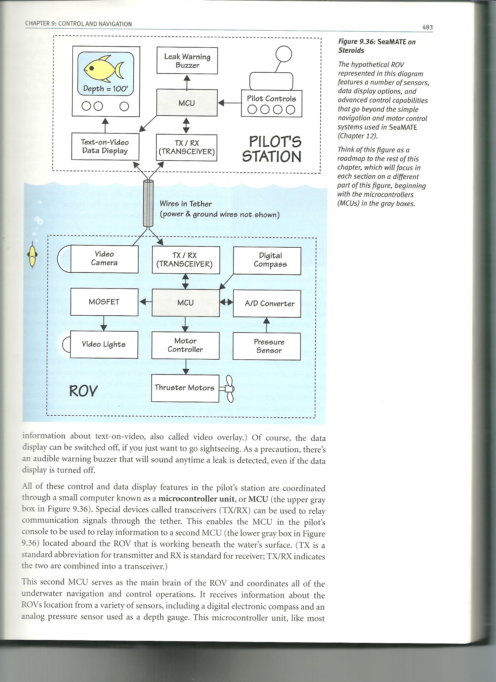

RV-BETANCOURT
Posts: 10
Joined: Oct 25th, 2012, 10:46 am
Re: MOTOR CONTROLLER FOR BRUSHLESS DC MOTOR
Post by RV-BETANCOURT »
I´m trying to use this configuration for the signal transmition, The joystick will be connected to the stotion´s Microcontroller Unit, the to a transreceiver and then all the way down trough the theter to another transreceiver in the inside of the rov, then to the MCU in the ROV and the motor controller is to be connected to the MCU... Now, my ROV is going to have two vectorized trhusters and two horizontal trhusters, so I will need four brushless ESCs, but what kind of MCU will work for me?.. I saw someone used something like this in the design of his ROV http://sine.ni.com/nips/cds/view/p/lang/es/nid/209757
