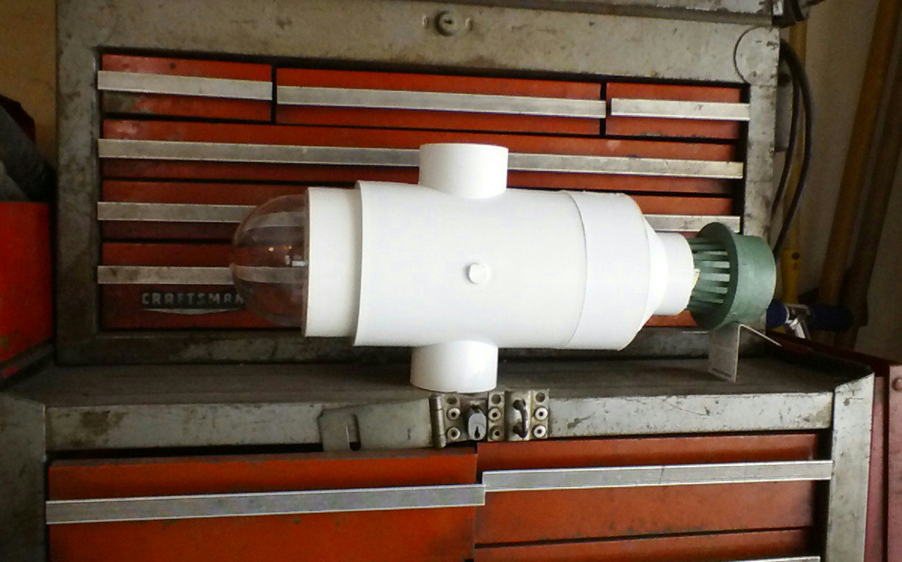

I couldn't help it.
I started a new one. I saw these 4x2 reducer tees and got this design in my head.
This will just be for pool use. It will use a vertical thruster inside the sleeved 2" section of the cross, a single rear thruster ans a bow thruster for steering. I may have to add a rudder too, I won't know till I see how much authority my bow thruster has.
The dome is from a Harbor Freight fake security camera... thanks to Chriz0138 for that.
So now I have two in the works...
My wife's gonna kill me. ;)

Love it! Really REALLY like the use of the Atrium drain as the Thruster Cover! Really wish they were easier to get a hold of here in the UK!

I just kinda stumbled on the atrium drains while looking over pvc fittings. I think they are going to work out well.
I'm not sure what kind of depth the cheapie dome can handle but as the pool I'll be playing in is only 10ft deep, I figure it should be fine.
I have been toying with the idea of a smaller one yet. Something 6" or smaller in length using these for propulsion.

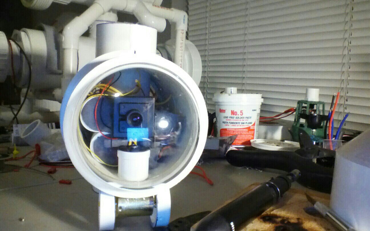

Hey Scuba,
I really like what you've done with the strafe motors! Can you describe the bottom seal and latch (or at least that's what it appears to be) and whether you'll be using the opening for an ascent thruster? Is the camera fixed or do you have pan/tilt (or is it just sitting in there for appearance :) )??
Heaps of progress!!!
Re: The Guppy
Posted: Apr 13th, 2013, 7:57 pm
by scubersteve
The camera will be functional but will be stationary. This rov will actually be radio controlled and will only use the tether for video purposes. It's for very shallow use only (15 feet or less)
The lateral thruster is a double shaft 12v motor with two 30mm props. It is located at the front for steering so the vehicle won't move laterally. The advantage over a rudder is that it does not require forward motion turn around.
The vertical tube does indeed house my vertical thruster and there is no access point on this model once it is sealed.
I am going to use flowable silicone windshield sealant on the joints and spray the whole thing with aerosol plasti-dip.
The batteries will be sealed inside but the power will be switched by means of two jumper wires on the outside of the hull.
If I ever have to open it back up I will have to cut along a seam and peel off at least some of the plasti-dip.
I'll let you know how that works out. It was just too expensive to design in a sufficient access port.
The problem I'm having right now is with the 12v brushed 1200 rpm gear reduction motors I bought.
When I ordered my ESCs, they were reported to be able to handle 4-10 nicad cells. When they arrived today though the documentation with them says 4-7 cells. Well I tried the motor and prop combo on 8.4v and the thrust was pitiful.
So I had to rethink... I don't want to risk all 3 ESC s on higher voltage and I don't want to spring for new motors, so I took one apart to see what I could do.
The motors have a three-stage reduction unit and I think I can remove one of them. So now I'm off to the hardware store for supplies to finish the modifications.
I'll let you know what happens.
attachment=2]Camera(29).jpg[/attachment]

Front view
Rear view with tail off
