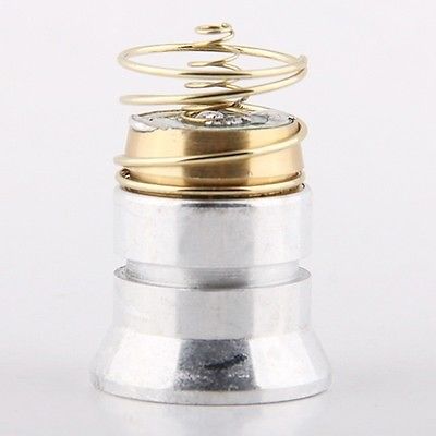

The lighting is a tricky part, I'm making my own using T6 leds with reflectors in aluminum housings. I got a few with different lumen and color temperature that I am gonna try out. I have no idea what works best so I am going with quantity (6 lights in total), it's hard to guess how much light you need and how well they will work so I am doing a trail and error approach on the matter :). The housing is a really tight fit to the reflector so I am counting on heat not being an issue with the aluminum housing but I guess I'll find out eventually.

Yes, the biggest concern is the cooling of the led and if you are not using a metallic housing, then you need to heat sink the led with an aluminum plate.
