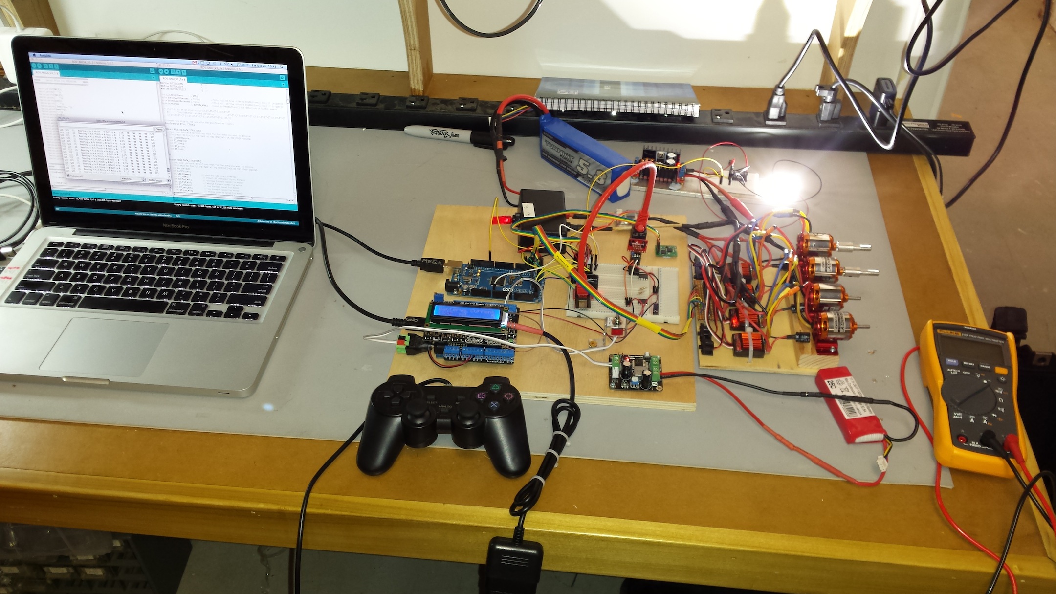

Well after a short hiatus, I am back at it working on the ROV! Spend the day rebuilding my test rigs and updating some of the hardware! Now it is time for software debugging... Good thing the winters are long in Chicago... it is going to take that long I fear!
- Got the Test rigs rebuilt!
- ROV2pointO.jpg (617.59 KiB) Viewed 17439 times
