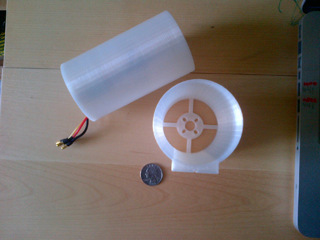

So, even though the final build may not be on track to finish this millenia, I am still pushing forward with the code and some of the other key components.
This week I recieved my custom 3D printed thruster housings, and worked out a few more bugs in my code!
Thruster housings can be seen here.
Here is a sneak peak if you can't be bothered to jump over to the other thread!
- Custom 3D Printed Thruster Housing.
- thruster5.jpg (249.21 KiB) Viewed 14262 times

Awesome thruster housing, by the way....
