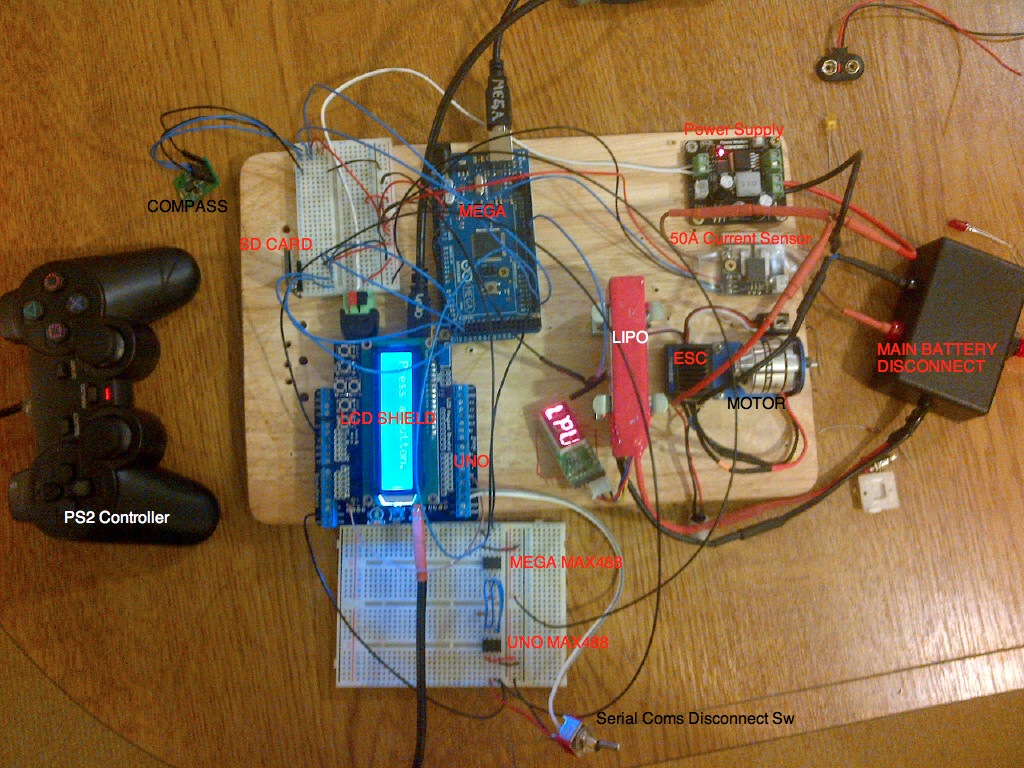

I have been working on my code recently, and I am ready to post an update.
Here is my current set up:
Current Control Setup
ROV Layout2.jpg (327.83 KiB) Viewed 24405 times
Arduino Uno (Surface Module)
1- PS2 Controller
1- LCD Shield
1- MAX488 IC
1- SPDT switch
1- Power Supply
Arduino MEGA2560 (ROV Control)
1- Micro SD Module
1- 50 Curent Sensor
1- MAX488 IC
1- Turnigy 18A ESC (no longer listed on Hobby King. Hope it is replaced soon!)
1- 11.1V 3S1P 1300mA LiPo Battery
1- Disconnect switch for LiPo Battery
1- Tilt Compensated Compass (no code in program yet...)

So. With this code, I am able to input the speed and direction of the motor (connected to the MEGA) via a PS2 Controller (connected to the UNO). If you run the serial monitor on the MEGA, you will see the XY values for the PS2 Controller, the zone (used in vectored thrust control), and the current draw on the main LiPo Battery. This data will also be replicated on the 16x2 LCD connected to the UNO.
Basically, all of the code is here to build a complete ROV setup. Some copy/paste and renaming of variables may be necessary, but this is the core of my program. I have no problems with you copying and using it. I would however appreciate a mention should you post it anywhere online (and a quick courtesy e-mail / post would be nice too!) I have spent countless hours getting the code to this state.
I would like to thank Bill Porter (again) for the libraries he created for the PS2 Controller Library and the EasyTransfer Communications.
Enjoy!

I assume you will have one current sensor from the main battery supply? Or do you intend one for each ESC/Thruster?
In either case, does the code above try to 'latch' any readings? For example, if just siting idle, the amps will read something low...correct? Then you bump the stick forward for a few seconds and then back to center. The topside station will get that momentary higher amp reading, but then settle right back to idle...correct? I wonder if a real-time, but also high-water mark (bad phrase for an ROV, but you know what I mean) readings can be displayed?

I'm so excited to see the massive progress that you have made and also extremely grateful that you have posted the arduino code! While you are a fair way ahead of where I am up to, there are so many similarities in our approach that I know I will be constantly looking at your code for guidance in months to come. A million thanks :)
