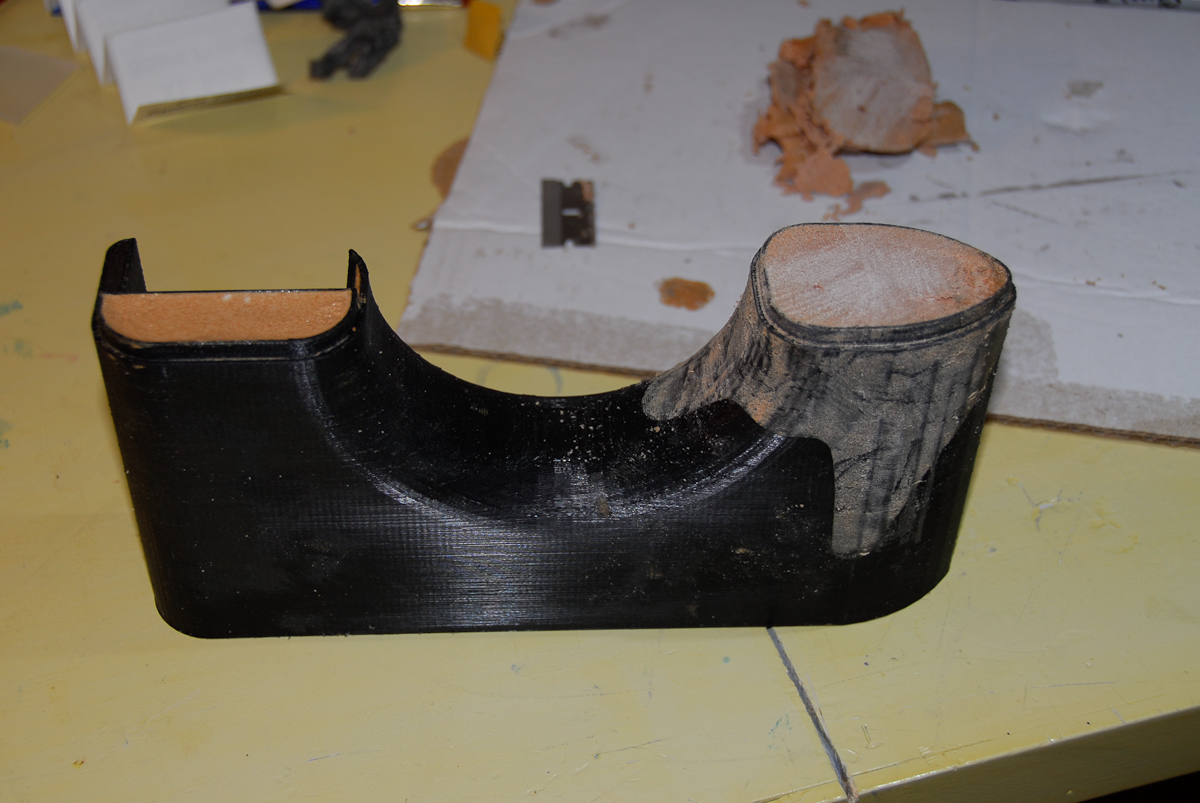

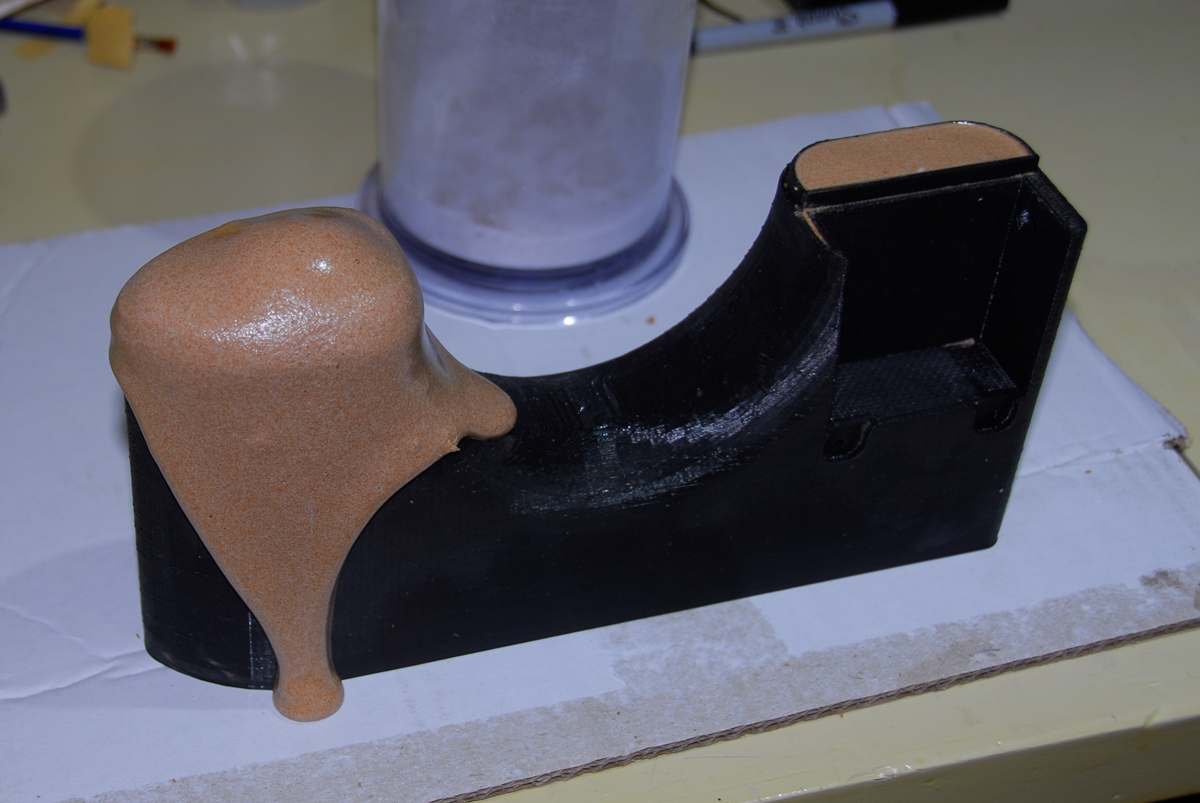

Houston we have a problem :shock: ...... I guess it's a good thing it wouldn't fit the pressure pot because when I checked on it an hour later I had a little bit of expansion of the front half. (so much for my gap) It seams like the thicker sections are curing faster probably because of the heat build up. The good new is while it was hot from the curing it wasn't nearly enough to melt anything though.
Thankfully it wasn't fully cured yet so I was able to salvage everything with a bit of trimming with a razor blade and a hobby saw. A little sanding later and it will be fine, as long as it doesn't grow any more overnight. :|

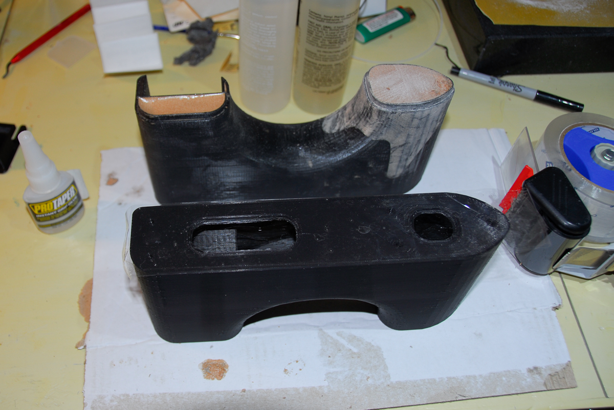

So in theory... I'm covering my windows with packing tape, I'm then going to fill this half with balloons the same way I did on the first half, then superglue the other half on top, and then flip it back over and let the balloons settle to the middle of this half and hopefully join with the other half...
... This should be fun. :?

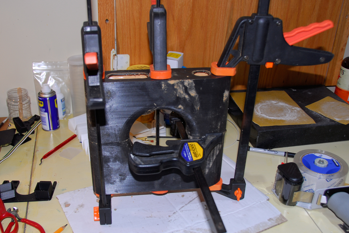

Re: Rov Reboot (3d Printed)
So far everything worked out pretty well. The filling went well and it glue together nicely, I put a bunch of clamps on it just encase things tried to expand it didn't separate the two halves.

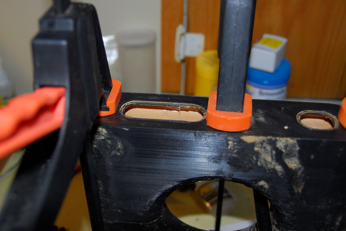

I poured it a little short so hopefully it expands again like last time and it will fill in the rest if not I'll just top it off later on and then glue the windows shut.
Now the waiting game starts again....

It came out good, got it topped of and the windows sealed up. This side didn't blow it's top so I hope there wasn't a huge air bubble in the last one. I haven't tested it yet to see if the buoyancy is going to be enough but I'm hoping to dunk it this weekend and see what happens.
