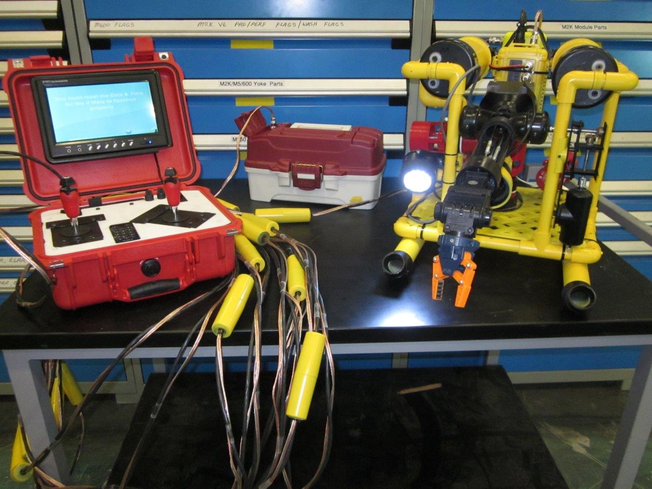

Post by Ian MacKenzie »
Making the tether. Much easier to do at work than in a 1 bedroom condo. With luck the first complete test will happen this weekend. Fingers crossed!

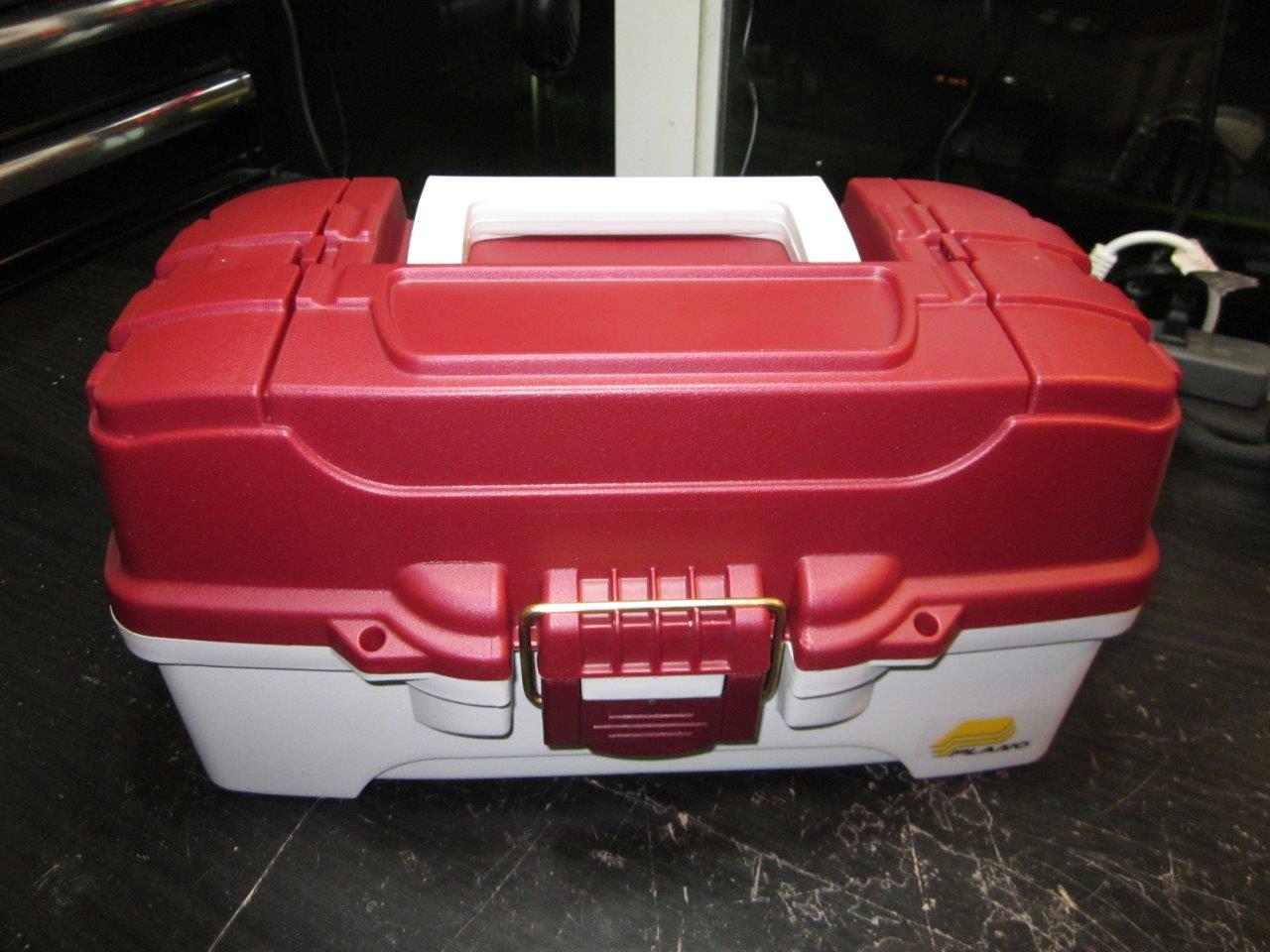

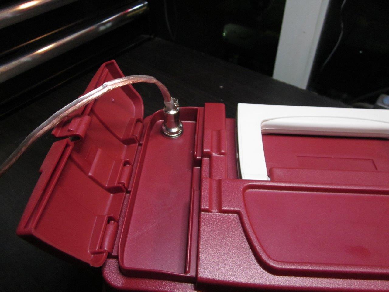

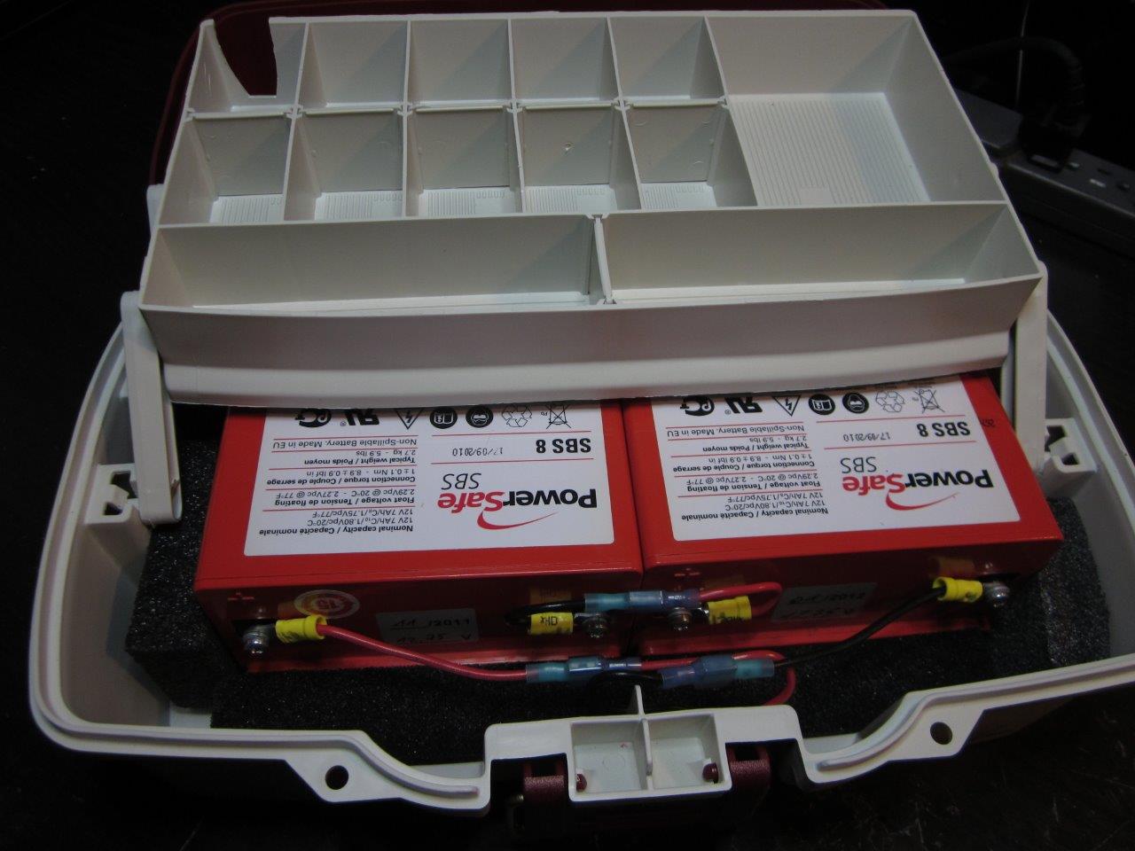

I finally got around to making a battery box
Battery box 009.jpg (134.62 KiB) Viewed 48904 times
Battery box 010.jpg (119.17 KiB) Viewed 48904 times
Battery box 011.jpg (121.67 KiB) Viewed 48904 times
Re: Retro- Retrofit Seafox
Oh! I like that! That little top compartment works GREAT for protecting the socket when not connected! Very clever!

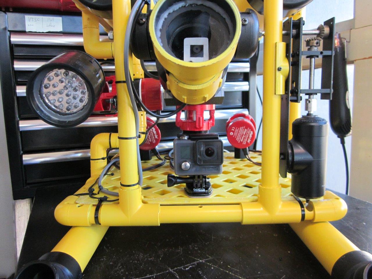

I couldn't figure out the DVR/camera recording issue, so I bought a GoPro Hero to do my recording. The original camera will still be my live feed.
