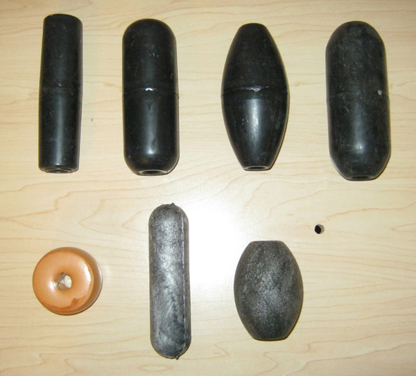

Someone posted these floats over at Robotrov and they might be worth looking into....
http://www.memphisnet.net/product/3761/floats_plastic
Still bulky and they would have to be attached during construction of the tether but still interesting, I might have to buy a few and fire up the pressure chamber to see what kind of depth they can handle.

I just ordered a variety of those floats to test out, I'll let you know how they are. ;)

So I received my order of floats from Memphis Net & Twine Company, I ordered a few of each, the top row is a variety of the Hard Plastic Floats, first one in the second row is a 2" Dia Standard PVC Sponge Float, and then we have a few Hard Foam Floats.
I haven't actually pressure tested any of these but I'm guessing from there make up they will all be good for the depths most of use are looking to achieve.
The Hard Plastic Floats are pretty solid, they are made in two halves and joined together so they have a center cross section. They are hollow but have a wall thickness of about 1/8" (I cut one in half and will post a picture of it later) the down side is .... the hole through them is only 5/16" (for some reason I was picturing a 5/8" hole when I ordered them.) so you wouldn't be able to fit much more than a ethernet cable through them.
Both the PVC Sponge Float and Hard Foam Floats are pretty solid too, they are not what I expected at all, I figured they would be somewhat squeezable, they aren't. Which is a good thing, I think they should withstand some good depths, but I still have to test them. I still want to hack a few up to see in they can be cut down smaller (to be less bulky) and maybe see if the hole can be drilled bigger, because they too only have a 5/16" center hole.
I'll post more as I continue with my tests.
