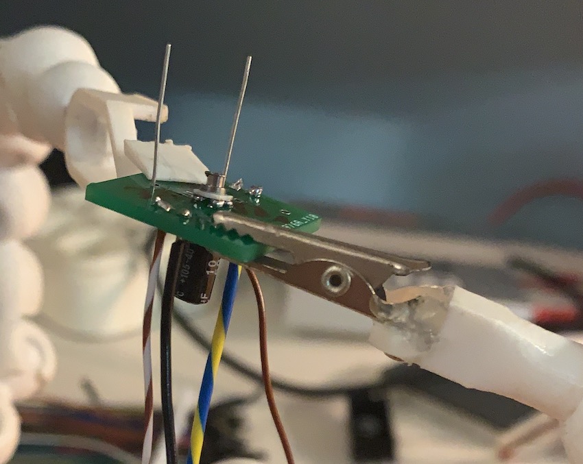

Some more updates...
Waterproofing a custom PCB I made for the I2C temperature and pressure sensor MS5837-30BA

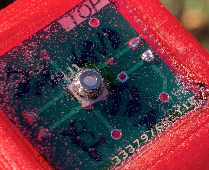

Here you can see the cad drawings for the pressure sensor. I made some tests and It gave me good values for pressure and for temperature. It stopped working after moving it. I used some very brittle copper wires and probably they broke off. Being it immersed in resin I couldnt repair it. I have another PCB ready with another sensor. This time I will use better wires.
CasePressureSensor Drawing v2.pdf
(393.02 KiB) Downloaded 4887 times

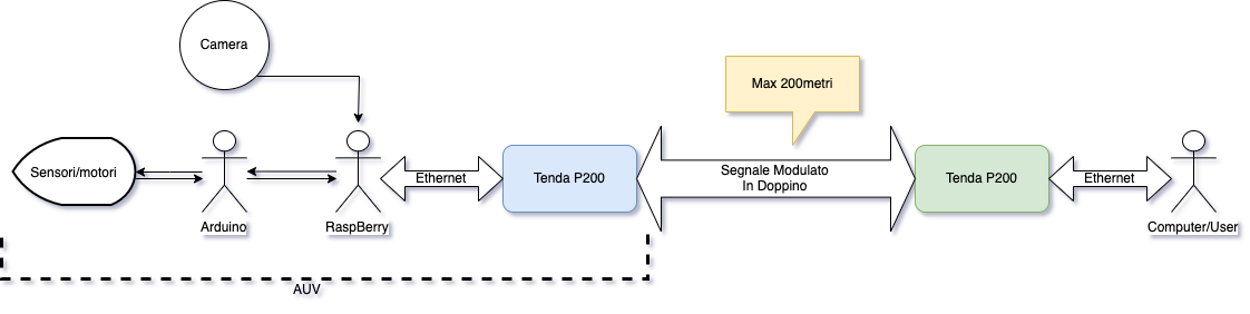

This is a diagram showing how ROV comunication works in the SUB (comments are in Italian... but it should be simple to understand just by looking at the images)
Untitled Diagram.png (55.17 KiB) Viewed 56899 times

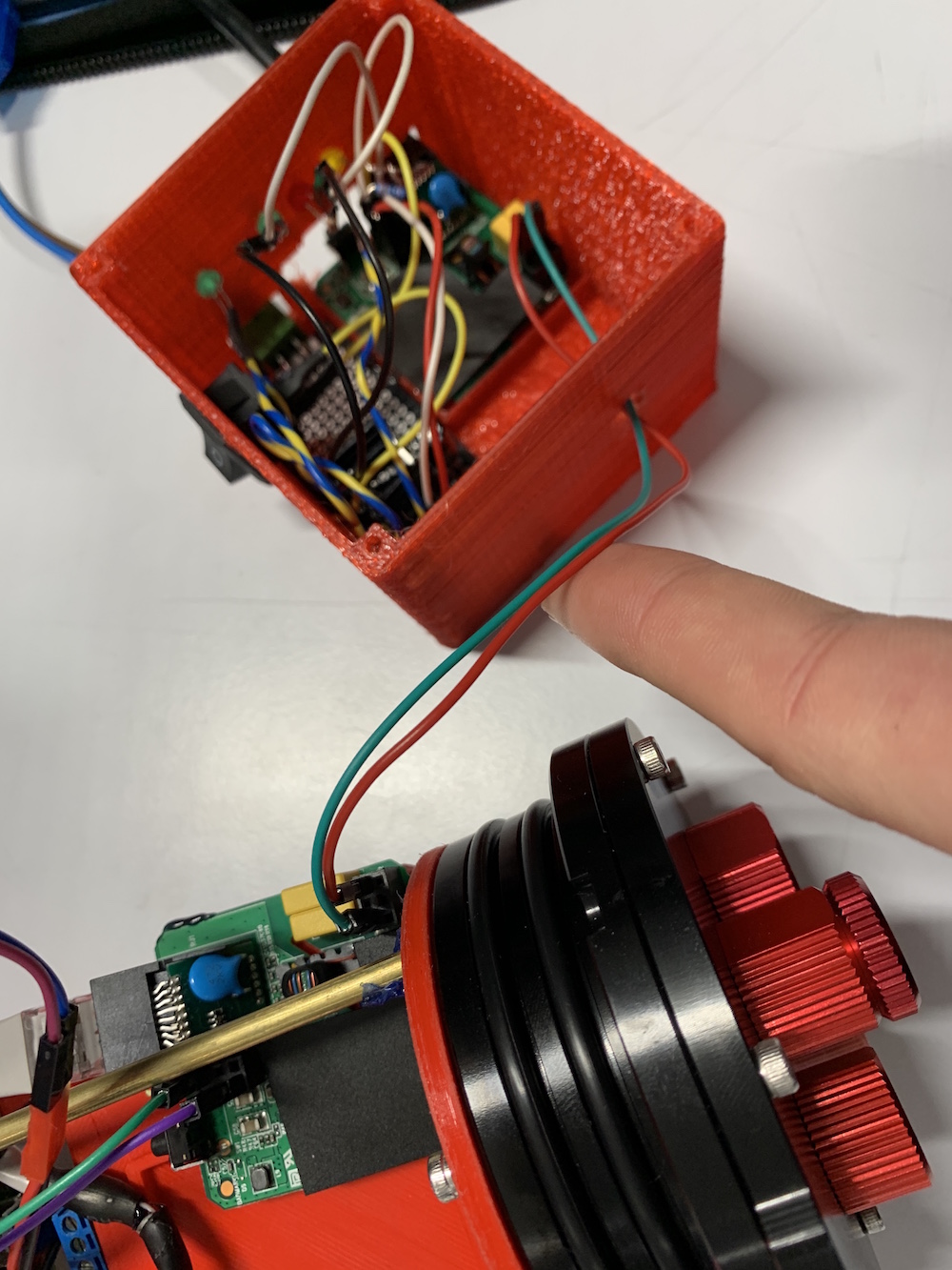

Test of the ethernet ommunication and control
Copia di IMG_5687.jpg (407.71 KiB) Viewed 56899 times

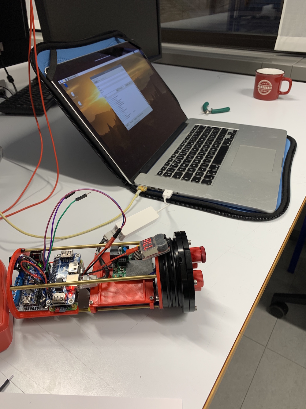

I decided to use VNCviewer for now to control the subamrine and view the USB camera.
Copia di IMG_5674.jpg (611.7 KiB) Viewed 56899 times

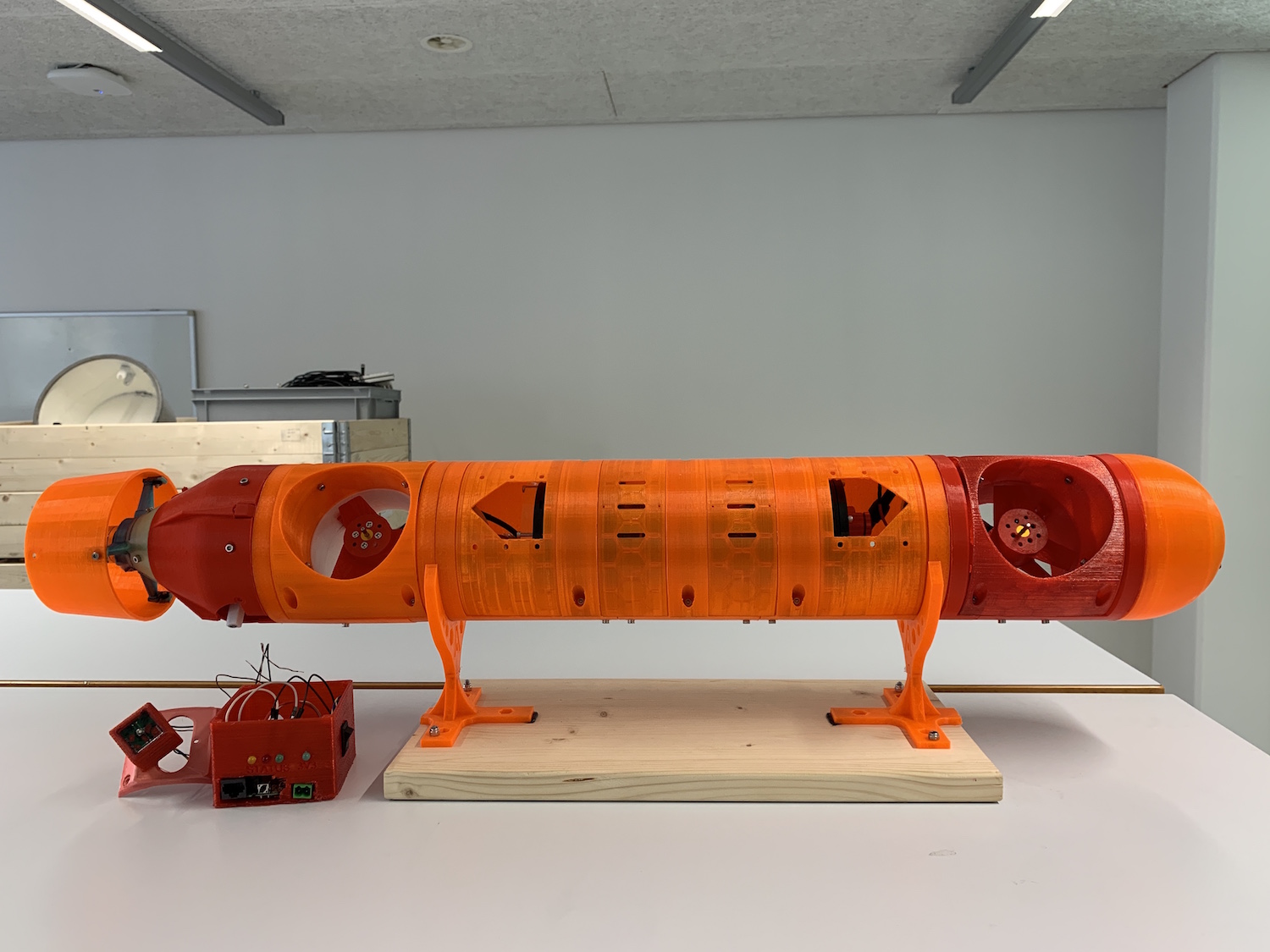

Final result
Copia di IMG_5735 2.jpg (338.12 KiB) Viewed 56899 times
