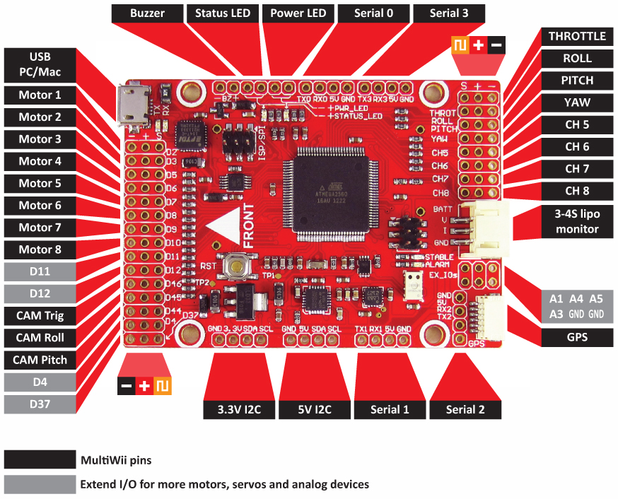

Just to throw another Arduino into the mix, I think my next bottom side board will be a Multiwii pro board. It has all the sensors on board and no end of inputs and outputs all for $40 or less.
Of course you would add your own sketch to it.
Re: Fibre optic tether
Gidday Ken. I tried to find a circuit diagram of the Pro to find out if the SPI was used for anything. The SPI is what the Ethernet shield connects to in a "conventional" Arduino. The sensors all use I2C, so I'm guessing that the SPI is free.
I reckon that board would be good on it's own if a cheap fibre CCTV converter could be found to do the video and data comms.
