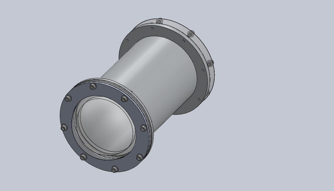

I was just thinking of keeping it safe an dry topside. But I will put it on the ROV. Now I just need to figure out what type of watertight container I'm going to put all the onboard electronics in. My frame is the Seafox frame, but instead of using bilge pumps I will be using the brushless motors and esc's. Maybe another 3" pvc pipe like the ones used for the floats. Somehow have a clear dome or flat plexi cover on one end for the camera?

A 3" PVC Pipe will work just fine, but are you going to use a threaded end, press fit, or actually seal it with PVC cement? PVC seems to be the most popular choice among people on this forum, and it is pretty cheap and fairly easy to do.
How are you going to pass wires through the pipe? Epoxy or some professional connector?
I am using a 3.75 ID aluminum tube that is sealed at the ends with o-rings and plastic. I am going to be getting a dome from cleardomes.com to cover one end of the aluminum tube, and the camera will be there on a tilt servo.
My robotics team has a small CNC (5.5x11.5in work area) so I will cut some 1/4in aluminum plates that will be welded to the tube.
Below is a 3d model of the design. I estimate they will cost me <$100 for two of them. They should be good to at least 200ft.

- This is the Main Pressure Vessel. 4.0 OD 1/8wall aluminum tube, 1/4in aluminum for the faceplates, 1/2in Polycarbonate and 1/4in acrylic for the backplate and dome respectively.
- Main Can Housing 0.75in .JPG (88.61 KiB) Viewed 4434 times
