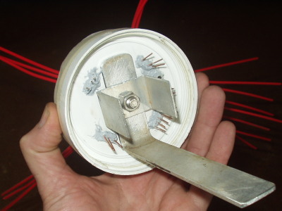

DNA and KR2: How you going with the ESCs? Possibly of interest I have posted some pics of my ESC and battery/electronics mounts which also function as a heatsink, should heatsinking be required. First I was just going to use a big washer on the outside but then found a lump of brass in the shed, so drilled and tapped a hole in that instead. This was handy to cable tie the wires to while potting, though that's getting off topic. Ideally all the metal parts would be aluminium or copper. Since taking the pics, I have fitted the ESCs. Made a point of checking that the ESCs own heatsink fins were not internally connected to the ESC wiring.
- outside.jpg (40.68 KiB) Viewed 9263 times
- inside.jpg (43.39 KiB) Viewed 9263 times

But your photos don't show the (pre potting) detail as to where the wires are in relation to the brass sink. Meaning is there one big hole and the brass and wires are stuffed in a potted? Or the wires have their own small holes, but in close proximity to enable a single potting glob? If the wires right next to the brass (or other metal sink), could there be any expansion/contraction that could create a small void between the wire and the metal (where potting has not reached). Or could the sink heat up enough to damage the wire insulation. I doubt the later, but curious.
Oh wait, I just re-studied. The brass is only what we see I the photo, correct? Meaning the hole diameter is not the size of that brass but rather the bolt from which is connected underneath. Which would mean the wires have their own small holes....yea?

Thanks for feedback DNA. Good to hear the bits turned up and you've had a play. Yep the ESCs seem very small for the amount of current they are claimed to do. In terms of power, that's about the legal limit for no registration and no licence needed assisted bikes and scooters in this country, so unless one's ROV is running flat out probably no need for concern.
Good points you made, and yes, just a small hole for the stud (chopped-off bolt). If a more effective heatsink was required, you would use something other than 8 millimetre stainless, stainless steel not being the best conductor of heat.
I thought about the expansion/strength issue, but even at worst case, epoxy is pretty tough and somewhat flexible.
(Off topic but anyway..)The wires are solid copper (=not stranded) with the insulation left on to help prevent them breaking off where they go into the potting and of course to prevent shorting out on the brass. The insulation has been removed 50mm or 2" from the end then the wire bent into an "S" shape with the long straight bit on the end which goes through a small hole drilled in the PVC cap. Cable tie is slid down over the bunch of wires and the brass. Fiddly! The grey stuff on the inside of the cap around the wires is polyurethane sealant- this stops the epoxy running out. Masking tape is wrapped around the circumference of the PVC cap to form a dam then epoxy poured. I used some local stuff similar to your WEST or System3. (fibreglass laminating resin as used in boatbuilding etc). If using epoxy, follow safety recommendations. Google "epoxy hazards". Some people have allergic reactions to even small amounts. Clean and sand surfaces to be bonded.
