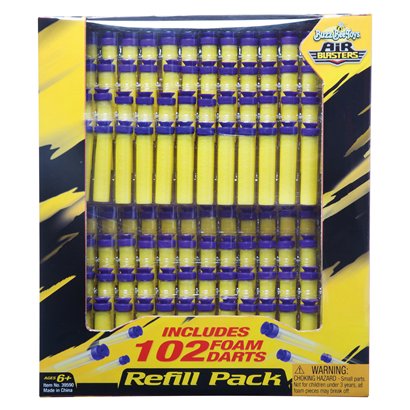

After doing a little bathtub testing, I found that the foam off of one Buzzbee (nerf knockoff) dart will support two feet of cat5e cable just under the surface. They are relatively cheap (50 for $10 at Target), not overly big(less drag), and have a properly sized center hole. Held on with a little gorilla glue they may bear further consideration.

scubersteve wrote:After doing a little bathtub testing, I found that the foam off of one Buzzbee (nerf knockoff) dart will support two feet of cat5e cable just under the surface. They are relatively cheap (50 for $10 at Target), not overly big(less drag), and have a properly sized center hole. Held on with a little gorilla glue they may bear further consideration.
I really like that idea! might have to look into that myself!
keep in mind though that with open cell foam, the buoyancy will change the deeper you go.
That said, it would still be worth a shot!
