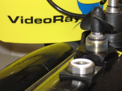

maybe some threaded rod down through it and into the hull with a BIG washer and wingnut on top, a bit like the videoray.

Well, I'm planning on pvc cementing a small piece of solid plastic round stock with a slight contour on the bottom right to the top of the hull with a threaded hole in it. Run a long bolt down thru the float. Rather not drill "into" the hull.

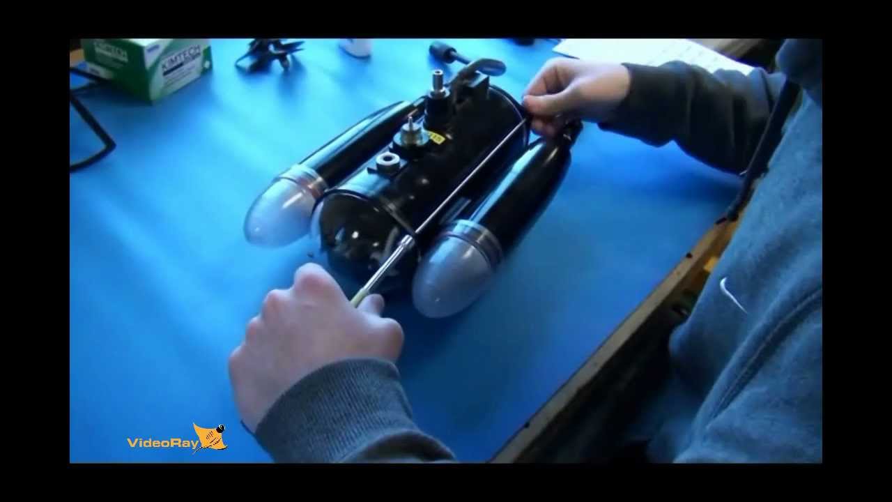

Re: My "MINIRAY" Rov.
Post by Demon340 »
PVC cement is incredibly strong, it actually melts the plastic a little as it bonds so you get pretty much a permanent adhesion. Here's a few pictures I found of the top of the Video ray with the float removed. Good reference.
