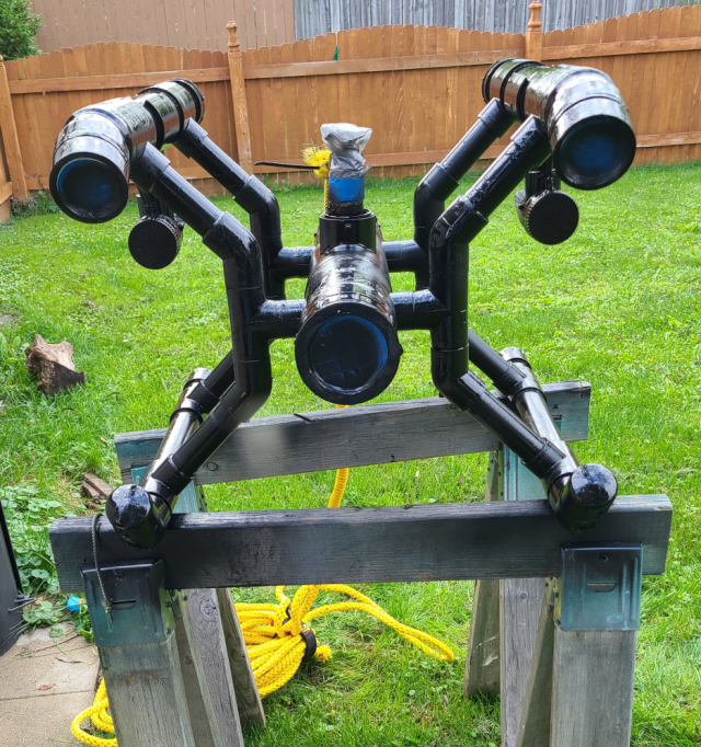

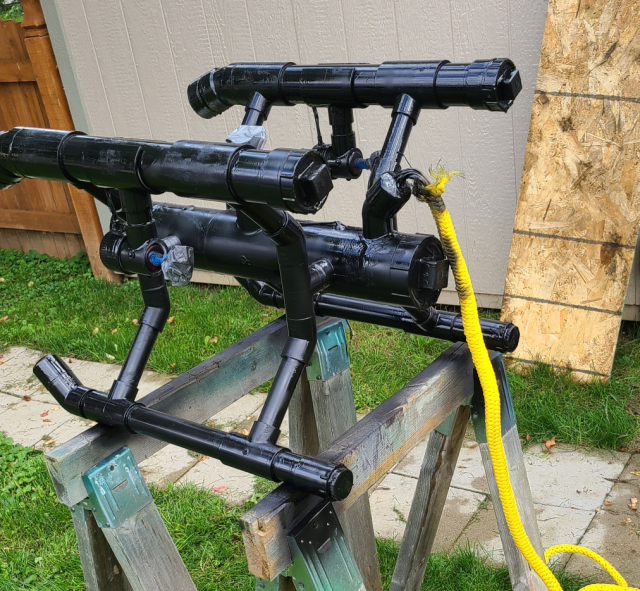

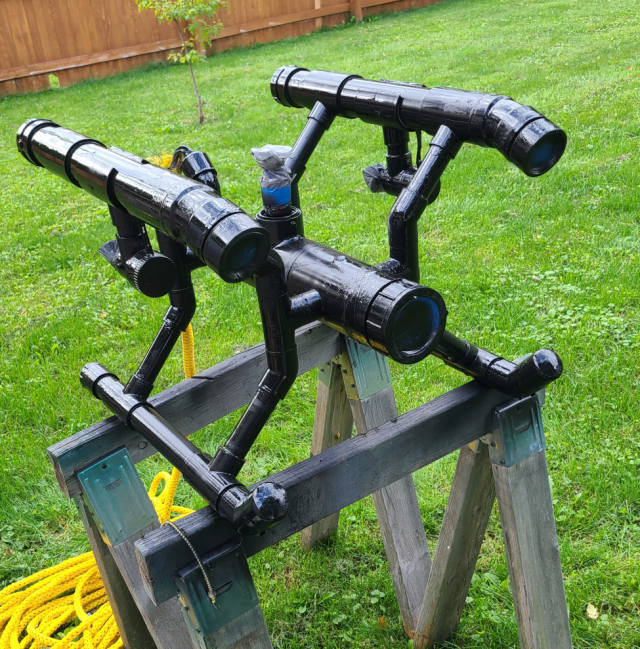

by jscott83
Monday I will sink it in the quarry, and hopefully it comes up lol
Excuse the blue tape covering the lights and camera.
I will be adding more color after the test dive.
