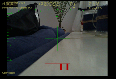

Not a lot of time, still some progress.
(Still no code yet available, sorry)
But this is, what it looks right now.

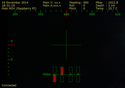

Latest screendump..
Not perfect, but useable and doesn't crash.
Schermafdruk 2014-11-19 18.31.19.png (174.11 KiB) Viewed 12025 times
olegodo
Posts: 222
Location: Bergen, Norway
Re: Raspberry PI based ROV
Post by olegodo »
Looking really good!

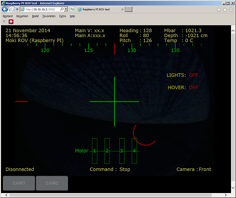

I think I am done, adding new features to the software.
Motors can be controlled using Servo ESC or Relay's.
Keyboard control (use awsd and jikl for movement)
'G' controls lights on/off
'H' controls Hover mode on/off
1/2 switch camera view (front/back)
CAM1 and CAM2 Button, opens new cam windows (without control overlay)
Sensors:
- Heading,Pitch,Roll,Depth and Temp (MPU-9150/MS5803-14A)
- ADC (ADC Pi Plus => 8 channel 17 bit analogue to digital converter)
- Volt/Current (AttoPilot Voltage and Current Sense Breakout - 180A)
Todo:
Flexible/configurable motor setup:
- select which motor, you want to use for a movement function.
- select servo min/max movement.
- Improve sensor speed. (i2c module, not shell script hack)
- Gamepad controller
Remember: This software was engineered... not designed ;)
PPs: screenshot was taken, while the PI was offline (sensor data is way-off)
