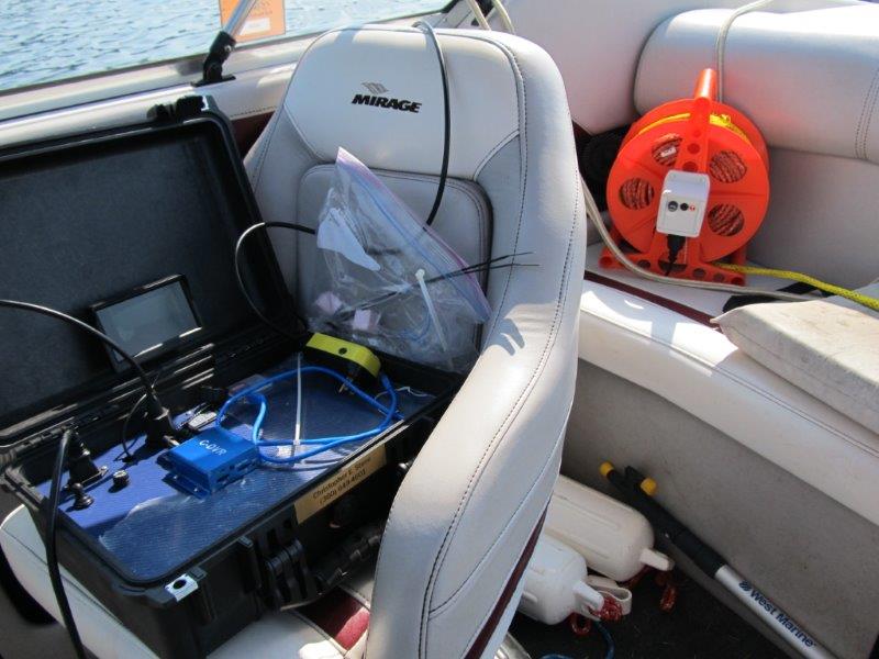

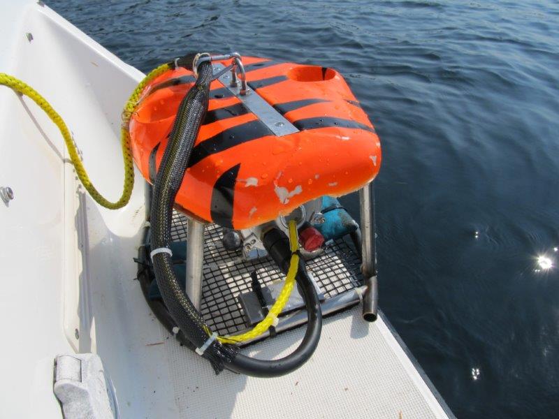

Pictures of the control setup and the float that crushed a bit at 65'.
Control Setup
Control Setup
Crushed Float
Crushed Float
Crushed float
Crushed float

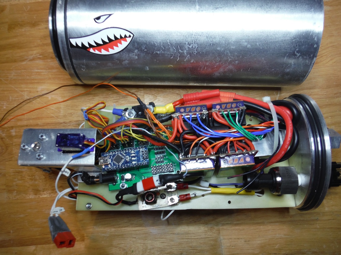

Progress on cramming everything in and wiring it together. Camera on the Left , Arduino Nano, and motor controllers. On the underside are the two Lipos.

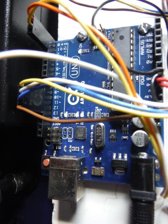

Just a quick update. I am having tons of trouble getting my 485 converters to work. I am using the wireless PS2 controller and can't figure out what pins to use for high and low to enable comms. It looks like the 485 examples have pin 13 but the PS2 is set on that right now. I am trying to use Nick Sopwith's programs since they do what I want and I can't get my programs to work but don't know what pins to use.
https://sites.google.com/site/underwate ... m/hardware
Any suggestions on where the pins are set in the program would help!
Thanks!

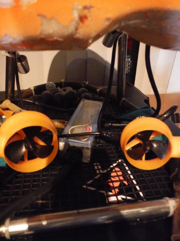

Thrusters and junction box which will be filled with oil and pressure compensated.

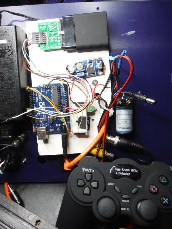

Topside Control System
Topside Board
Topside Board
