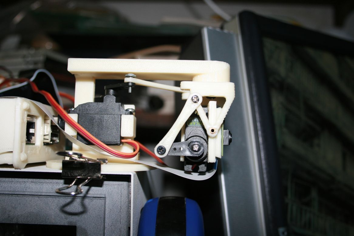

Well finally got it assembled yesterday the dual linkage at the top didn't work out even tho it looked nice, once side would bind up thankfully it was an easy fix. Just switched out the servo horn and changed out the dual linkage for one linked diagonally :D
Disclaimer: I actually had nothing to do with designing the front cover short of sticking the lens to it to see how a fish eye would work out. It was part of the camera enclosure I picked up on Thingiverses and I just decided to make the tilt harness compatible. Tho if I do decide the lens is going to be a permanent fixture I'll either have to make a new cover or see if I can get the STL for that cover to import and modify it.
Yes the stock ribbon cable that concerns me simply because it is a ribbon cable is far far too short. Tho I think I have found a source for longer cables.
Had to reprint another pan arm because I tried to sand it smooth where it attaches to the pan harness and managed to do so at a horrible angle..... then I remembered I am using ABS so I could have just given it an acetone wash and smoothed it right up ~.~ good times. At this point everything seems mechanically sound. Gently manipulating the servos causes the camera to move in the desired direction...... and now that the "easy part" is seemingly over its time to slam my head into a desk and cry myself to sleep writing the code to make it controllable.

The ribbon has the standard mini locking whatever they are called, so its securely connected and I'm not worried about it coming loose. Its more that the film ribbon cable really isn't mean to twist the way I'm going to be twisting it. Of course it isn't actually going to be twisting all that much. I think most of the problem is that this cable is just way, way too short. I really just hooked up the one I had for the sake of hooking it up. Getting it all put together, fleeting sense of accomplishment before the crushing despair kicks in lol.
Once I get a longer ribbon I don't think it will be much of an issue, I hope. If it doesn't work out I have a spare HD USB camera I can switch in with a few modifications. Course I had a more interesting idea for a camera mount for that one. At least less traditional. I really need to stop thinking about the small stuff and just build the ROV or I'm going to be nitpicking until forever. But if I just built it where would the fun be, I mean half the entertainment is figuring out how to put a jigsaw puzzle together when half the pieces don't even exist yet :P
