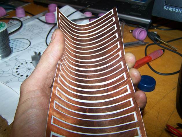

2. Knowing what's going on inside. Like FPV get an OSD to display data on your screen. Monitor battery voltages, current consumption, internal/external pressures, temperature, compass headings etc... and most importantly a leak detection system. It goes without saying if you get so much as one drop of water inside you want to know about it as soon as possible, so a properly designed leak detection system is a must.
This is my homebrew system and it performs exceptionally well.
http://www.youtube.com/watch?v=moE6Oryyvww
Felxible board1.jpg (54.88 KiB) Viewed 5546 times
