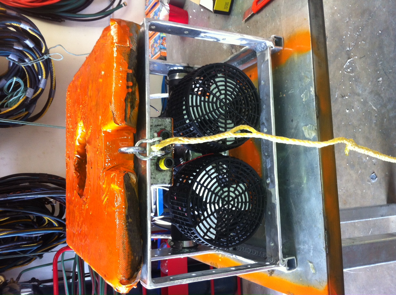

timothyalderson
Posts: 92
Re: Using computer fans blades as thrusters
Post by timothyalderson »
Im using a piece of short tubing with a bolt run inside the round open end on the bottom. I made the new skid out of aluminum. Its actually realy easy to mount these.
photo[1] (2).jpg (511.83 KiB) Viewed 5784 times

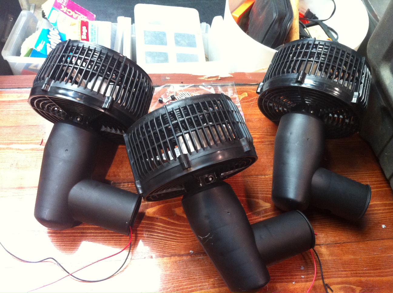

timothyalderson
Posts: 92
Example....
