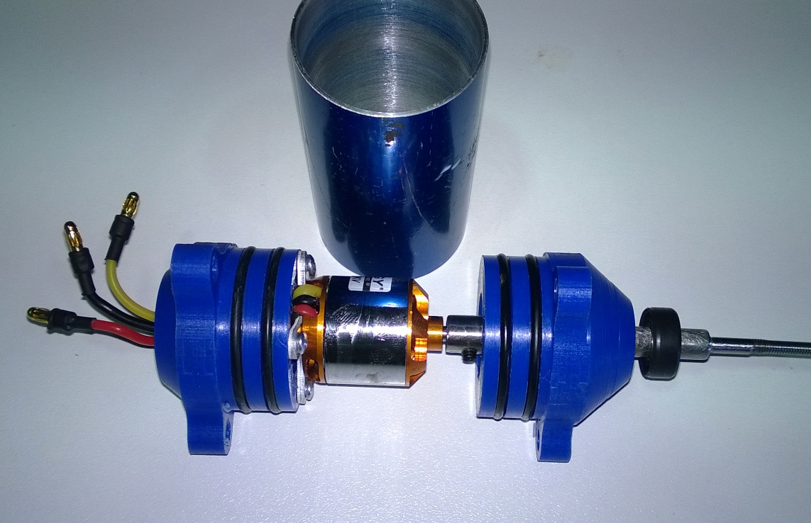

Exploded view
Exploded view
X-Ray view
X-Ray view

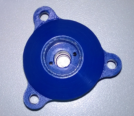

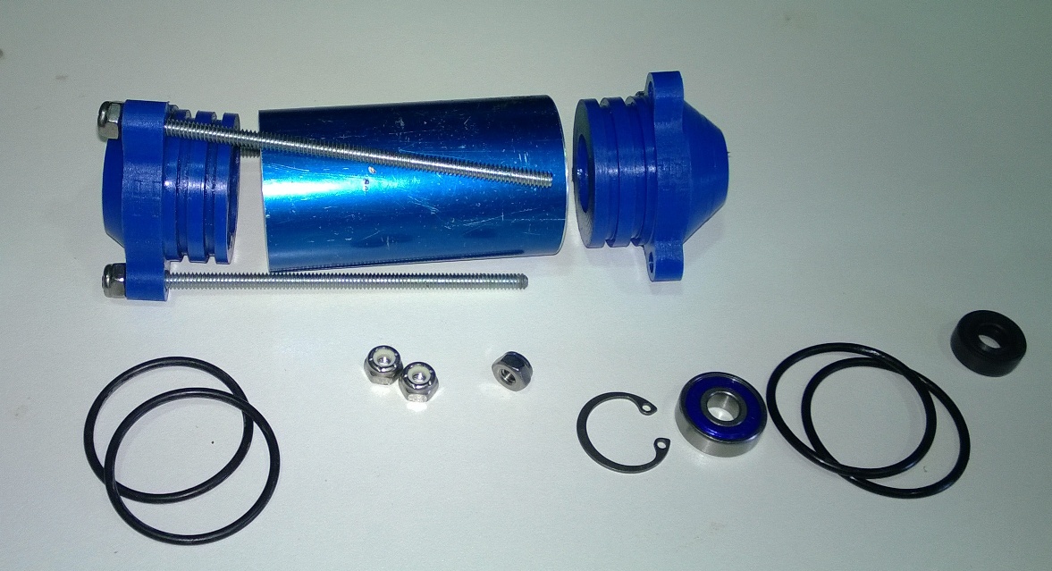

Oil filling holes
Oil filling holes

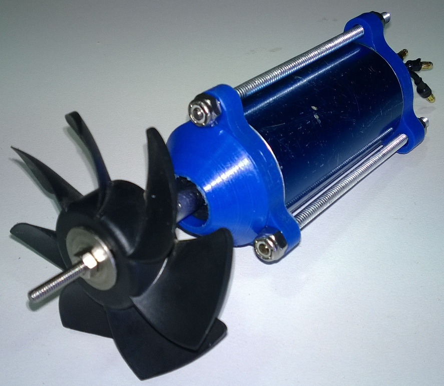

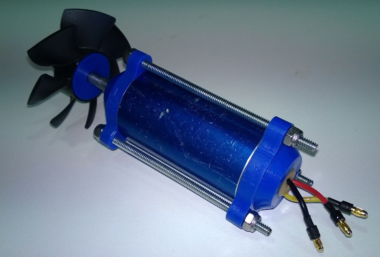

Front view
Front view
Rear view
Rear view

The fan is from an old PC, it was the CPU cooling fan. I've got some no name props on order from Hong Kong, but really like this fan, certainly compared to the cheap airplane props on my test rig. I may go to the tip (dump) tomorrow and see if I can get a few old PC's to recycle. :D
The bearing is a standard run of the mill skate bearing with the seal removed.

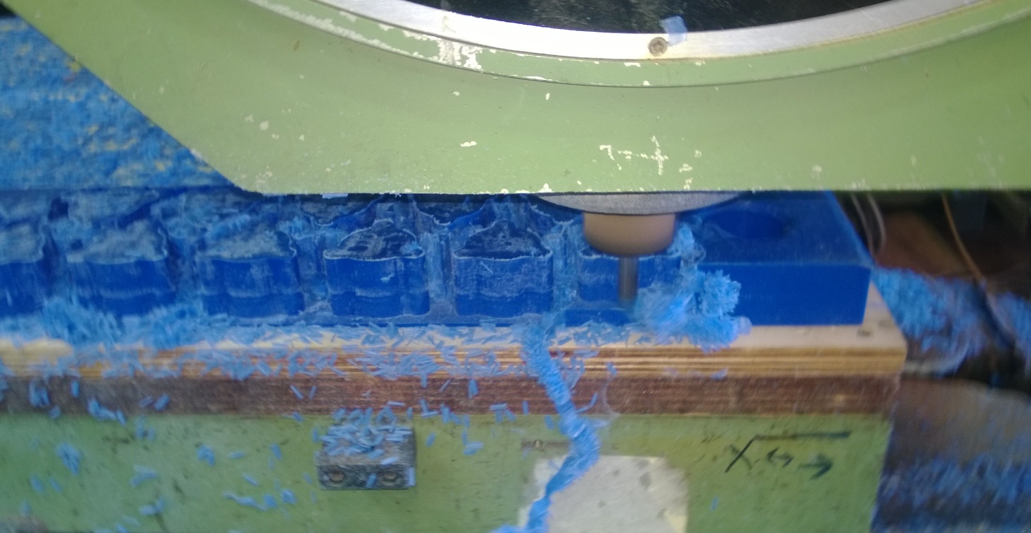

Nice-looking job. Curious how you made the ends. CNC lathe/mill? The oil issue can easily be solved, but usually adds bulk to the thruster assembly. Put a hose barb of say 15 to 20mm OD in where the beeswax is (or machine another end), solder longer wires to the existing ones, and slide on a thin-walled silicon tube that matches the barb. Seal the other end of the hose with another barb, with the wires potted in. Once you've filled the assembly with mineral oil (just slide the hose back) and removed as much air as possible, put some kind of spring clamp along a section of the tube. You now have a positive pressure bias on the inside of the thruster assembly.

Thanks Ross, I used a NC router to machine the basic shape then did the rest on a Lathe and Drill press.

I will also fill the the thrusters with cutting oil and distilled water, just to see how it goes? I fill the the housing from the top before pressing the oil seal in, I'm pretty sure there is no air left in there. In the third picture you can see the small holes I have drilled, they are behind the seal. I insert a syringe through one hole and down through the bearing race so as to fill from the bottom up.
