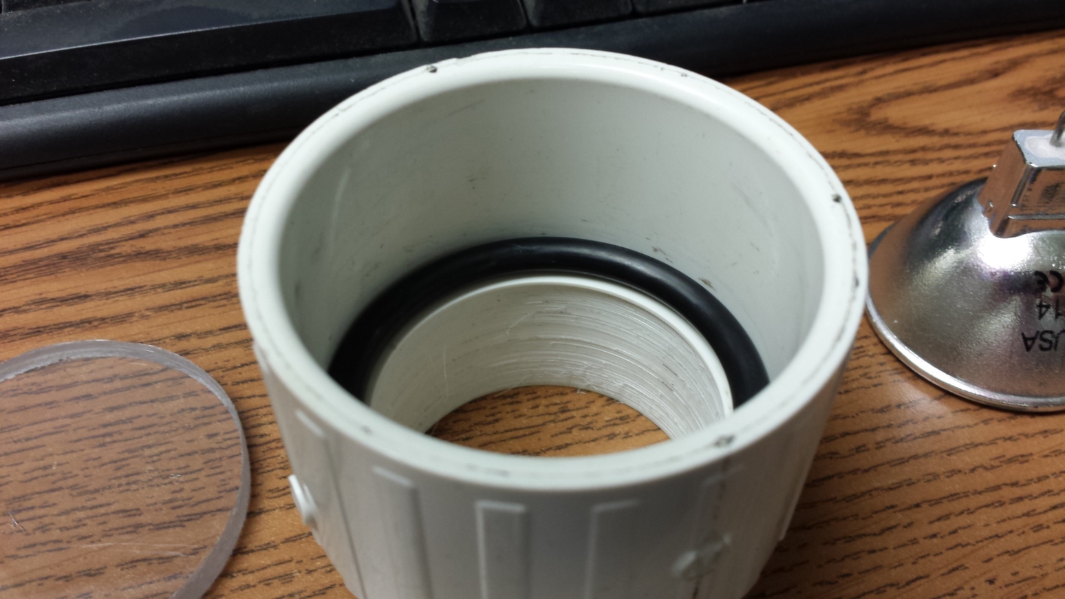

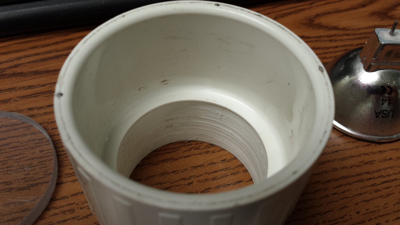

Heat. Well, I'm sure they will build up some heat. But I figure since they will have an off and on switch and won't be on 100% of the time and housing will be surrounded by much cooler water, I don't think that will be a big issue at the moment. The construction is a mock up of the how to section on Homebuiltrovs.com main site. I just modified it a little so I can replace the bulbs if needed. I'll have a solid state relay or a mosfet handling the On/Off. Depths unknown but I'll have a complete assembly done and in the water soon.
I used these to squish the o-ring down then ban-sawed the rest off.
I liked these couplings since it has a nice shelf for the o-ring to sit on.
