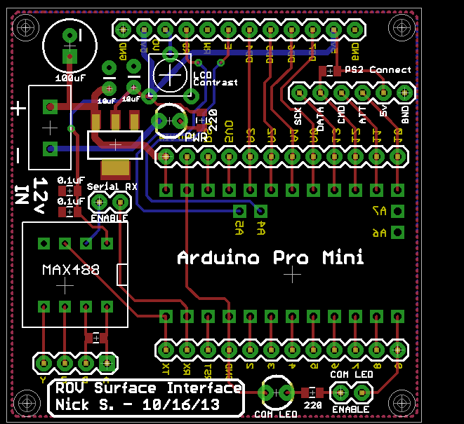

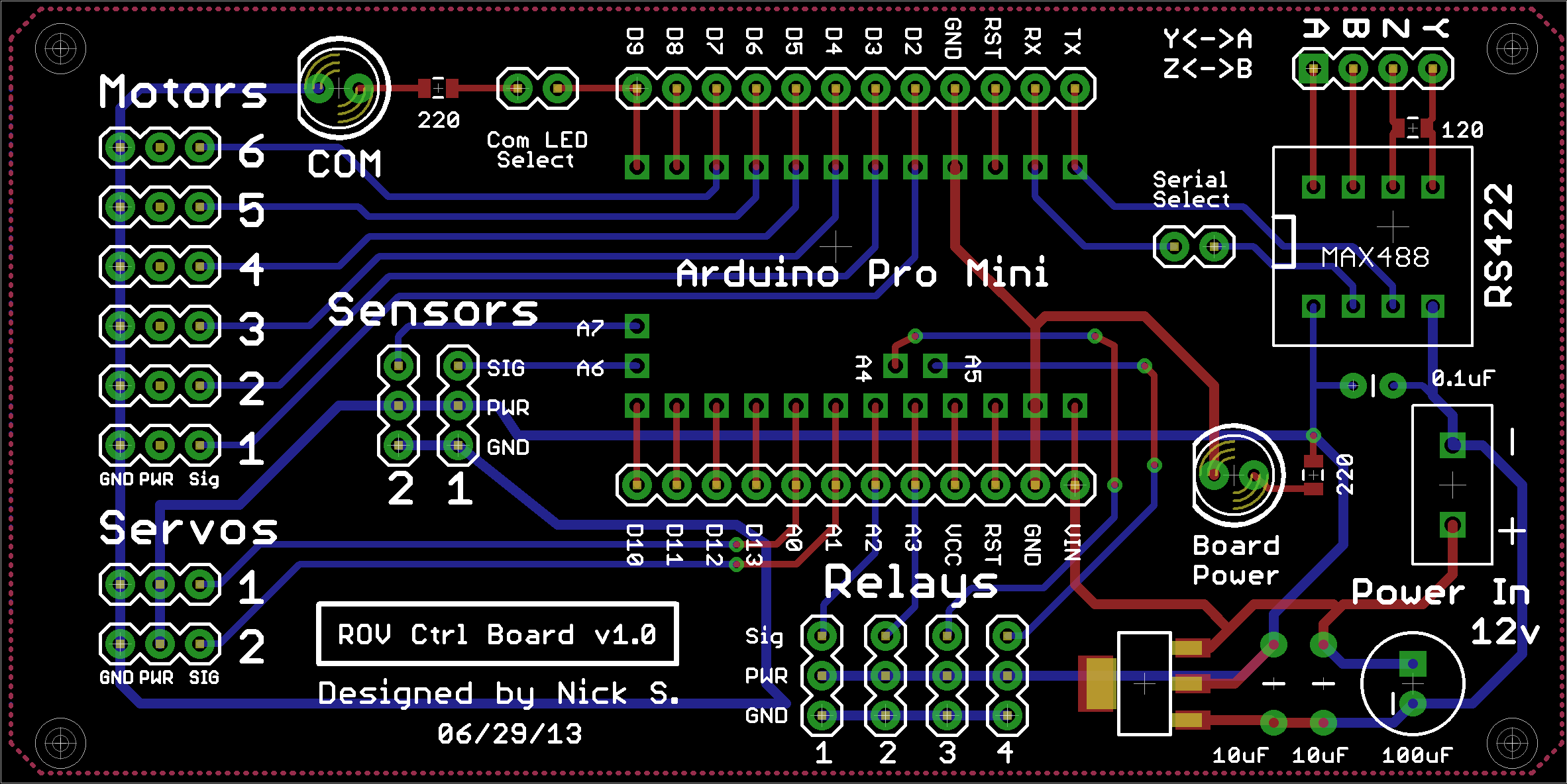

I have one of Nicks' original bottom side boards that I can check but I'm not sure what your asking? There is a serial select that simply turns off the Rx or Tx (can't remember which) so that you can load a new sketch onto the arduino.
I have attached a few pictures that I got from here or Nicks web site that should show what you need, it's been a long time since I played with it.

Working on it now and I think everything is hooked up right. Can I just use the two A and B connections between the RS422s? I am under the assumption this is half duplex and comms only go one way.
Re: TigerShark ROV for exploring Puget Sound
My understanding is that the MAX488 only works with Full Duplex, there is no way to make it work in "Half duplex" mode... i think..
I put together a thread with my notes on the MAX488 a year or two ago.
You can find it HERE.
Suggest double checking wiring between two boards. I see Nick used A, B, Y, Z to label pins... wouldn't hurt to double check you have the pins wired correctly...
