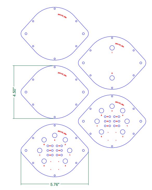

At the moment, I am planning on using the 4" hull package from BlueRobotics, and I plan on custom designing my end caps.
The end caps at BlueRobotics Retail for $16 - 26 USD each. I submitted a quote to Pololu for a total of 5 pieces of custom end caps, cut from 12mm clear cast acrylic, and the total quote was around $75.
That works out to roughly $15 USD each.
My design looks something like this:
End Caps Quote
End Caps Quote
pololu quote.JPG (51.39 KiB) Viewed 6619 times
Blue lines will be cut, red lines will be vector etched.
The dimensions shown in this file are the dimensions of the drawing; the actual part sizes will
likely vary by around ±0.01", and they cannot promise any particular tolerance. Note that the
laser also cuts at a slight taper (probably around 1-2 degrees).
Just thought I would share this for the good of the group.
Happy Diving,
"KR2_Diving"
