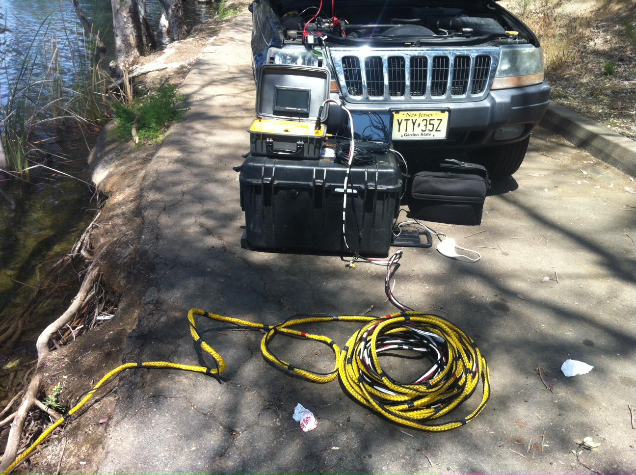

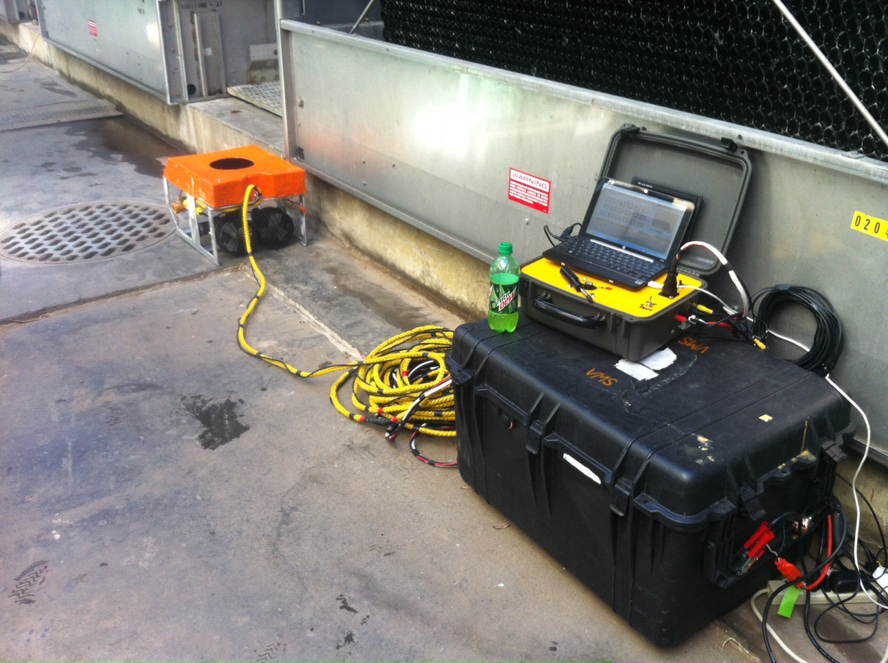

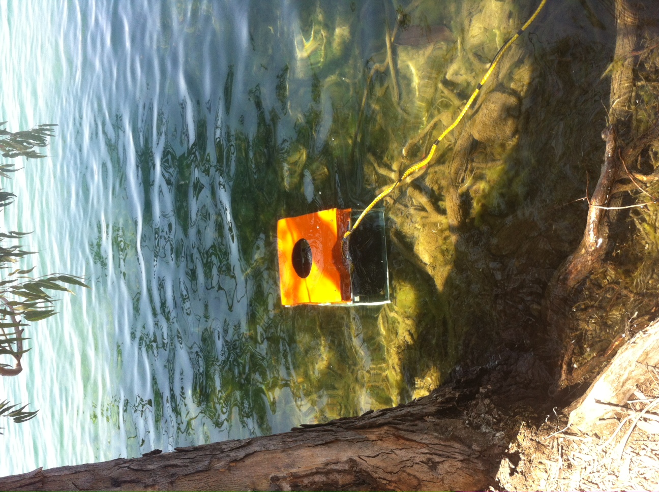

Ok. What is needed for communication? I can make anything but I don't know what to make or use. I have zero knowledge with arduino. And a compass etc would be nice. I'm looking at the OPENROV kits know but still want this one working also.
				- a.JPG (688.22 KiB) Viewed 3246 times
				- g.JPG (592.89 KiB) Viewed 3246 times
				- h.JPG (537.11 KiB) Viewed 3246 times

See some of the other ROV projects around here for communication, most I have seen are either serial or UTP and then TCP/IP or UDP. Openrov is using TCP/IP over a powerline network adapter.
BTW those pictures look awesome.
