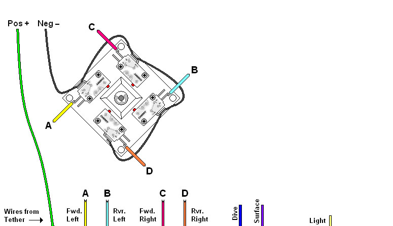

This is a basic Arcade Type Joystick assembly that you can use to control your Rov's Forward, Reverse, Left, and Right Movements. This is a digital joystick and control is accomplished with 4 simple snap switches that handle 4 relays, there is no need to use microcontrollers or even build any circuits for this hookup, just some more basic wiring.
This is what the 4 snap switches in your joystick should look like. You will be using the Com (common) and NO (normally open) poles, the NC (normally closed) poles will not be used during this hook up.
| You will be mounting the Joystick assembly in your control box diagonal so when you push forward on the Stick the Joystick Control Block will press on two of the switches at the same time. When you press the stick forward the Block actually moves toward the rear switches, in these diagrams you are looking a the bottom of the joystick. You'll also notice that the Left and Right Reverse Switches are labeled backwards, this will become apparent later on in this write up. |
The first step is to wire all of the Common Poles together.
The next step is to start connecting in your Tether wires from your Relays. (Below is the Relay diagram for reference.) For ease of my drawing I didn't draw the actual wires to running to each switch here so just connect A to A, B to B and so on. (For this step you are just connecting A thru D. for now.)
Power for the relays will depend on the relays you bought. If your relays are run from the same power source as your thrusters you may be able to tie in the common positive on the Rov from the main power feed instead of running a separate wire through the tether.

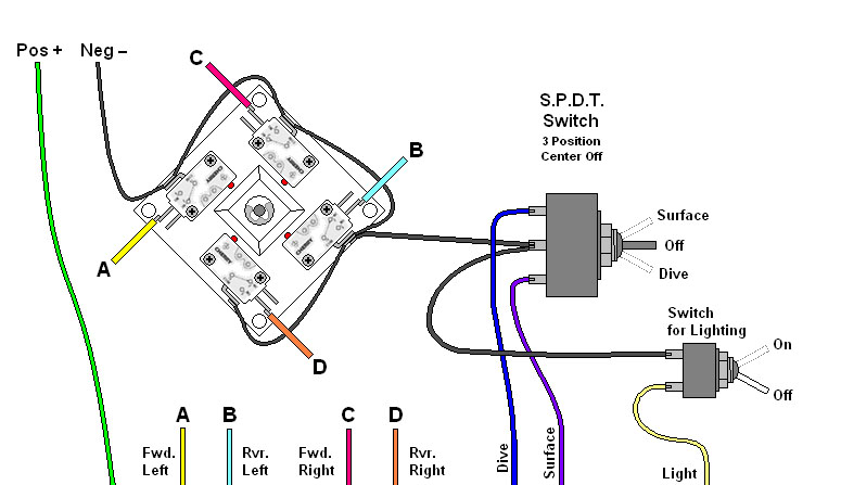

Then you will be using a Single Pole Double Throw Switch for Depth Control. You could use another joystick for this but I just showed a Switch for ease of drawing. If for some reason your Vertical Thruster runs the wrong way either change the two wires around or you can even flip the switch over in the control box.
Control of the light can be any kind of toggle or even a push button switch (just make sure its not the momentary type)
