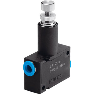

I found that unscrewing it completely closed the valve so you're right, it needs the screw in a couple of turns to balance the upper and lower springs.
I also found it's a self relieving regulator so I don't need the blow off valve in the hull but it's in now so it can stay there.
This also means the water pressure acts on the diaphragm through the pressure relief vent which is what I need.
A quick dip in the tank shows tiny bubbles coming from the thrusters so it's doing the job of keeping the water out of the wiring.
