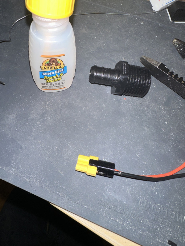

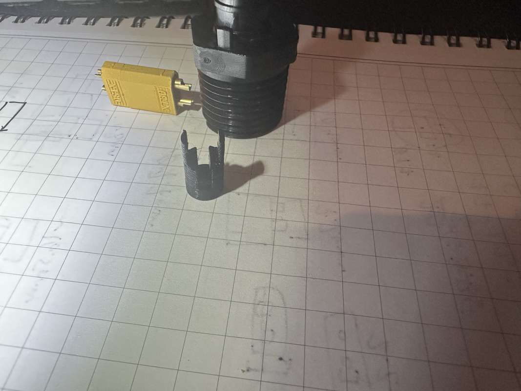

Pictured is the male adapter as well as the clip I 3D printed. You can see how it works below:
The clip sits inside the barbed inner hole and the connector sits inside the clip, which holds it in place.
So, step 1 is to print out 1 of these clips for each connector end, so one pair requires 2. I recommend printing a bunch of these as they're delicate. A link will be provided at the bottom of this post.

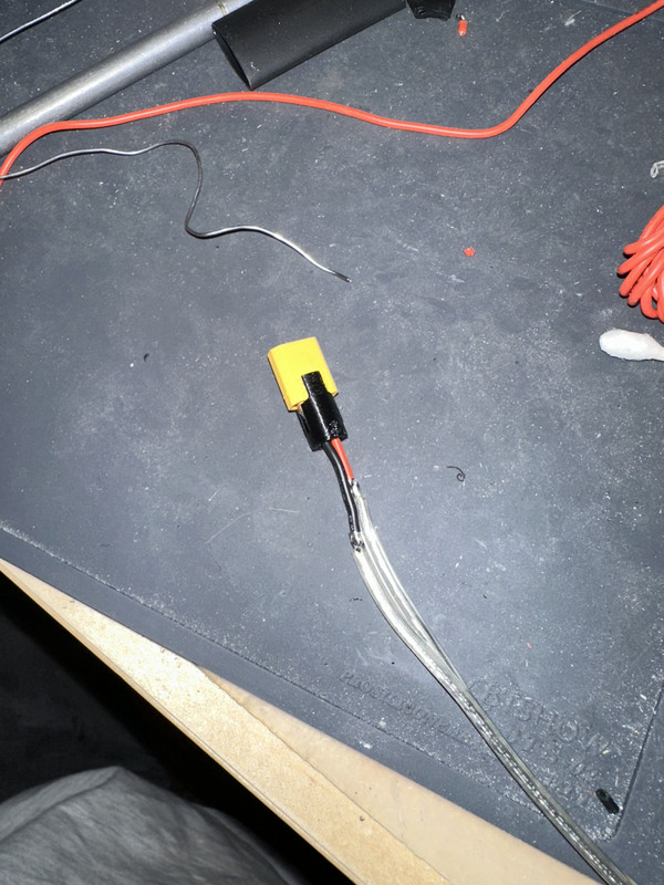

Step 2 is to prepare the connectors. I soldered 20 gauge stranded silicone wire onto each connector end. This would be my recommendation as well, though you may be able to fit 18 gauge stranded silicone wire through the clip, 20 gauge is likely enough for LED accessories or small motors. This can be a short length, but long enough to fit through the whole fitting with some room to solder on extensions, more on this later. Do NOT use heat shrink here, cut and strip your wires so they don't touch.
Here you can see the connector with the wires through the hole in the clip and soldered on. I also cut some insulation off at staggered locations to hopefully get some resin flowing into the strands for sealing purposes, though you can probably skip this as the solder joints being exposed accomplishes a similar goal.

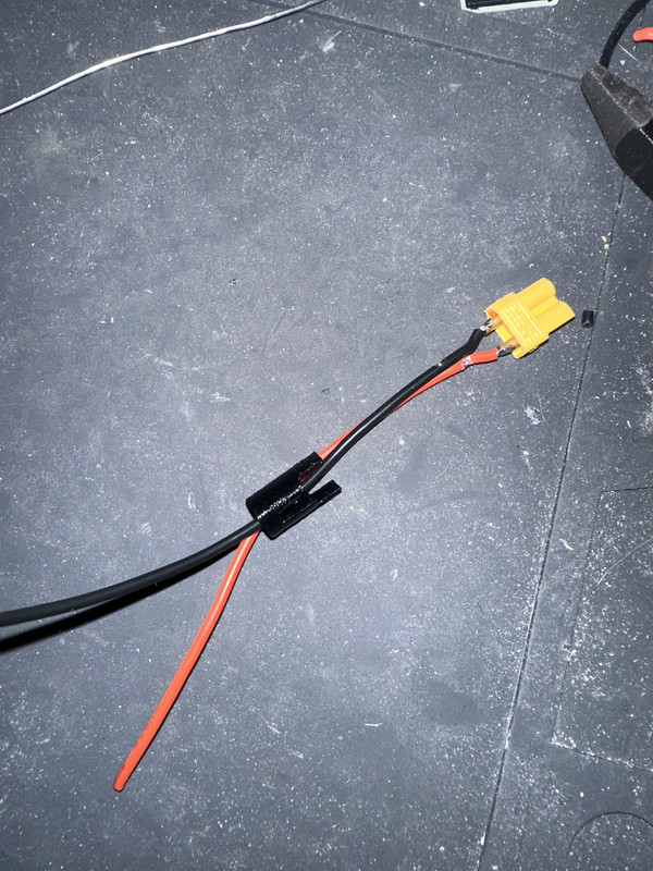

Step 3 is to snap the connector into the clip, approximately centered across the wide face and all the way down in the clip.I recommend doing a dry fit then using a little dab of superglue just to hold it in place, this makes further dry fitting easier.

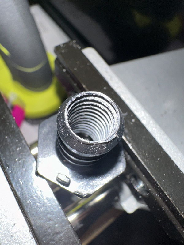

Step 4 is to prepare the fittings. From the OUTWARDS end of the BARBED connector on the fitting, use an 8mm (approximate) tap to create ridges inside the barb. This gives the resin more grip and mechanical strength inside the fitting. I used a 5/16 tap for some, and it was definitely too large. 8mm is a lot closer but to be honest, you could probably go down a size further and still get good results while being an easier tapping operation. I just grabbed the barb in some vise grips and *carefully* spun the tap in my drill.

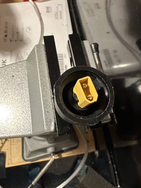

Step 5, insert the clip, wires, and connector into the fitting, wires first through the inside (so the wires exit the barbed end).
This isn't the best image but make sure the connector is centered inside and press it ALL the way down, so the back of the connector is flush with the base of the inside of the fitting.

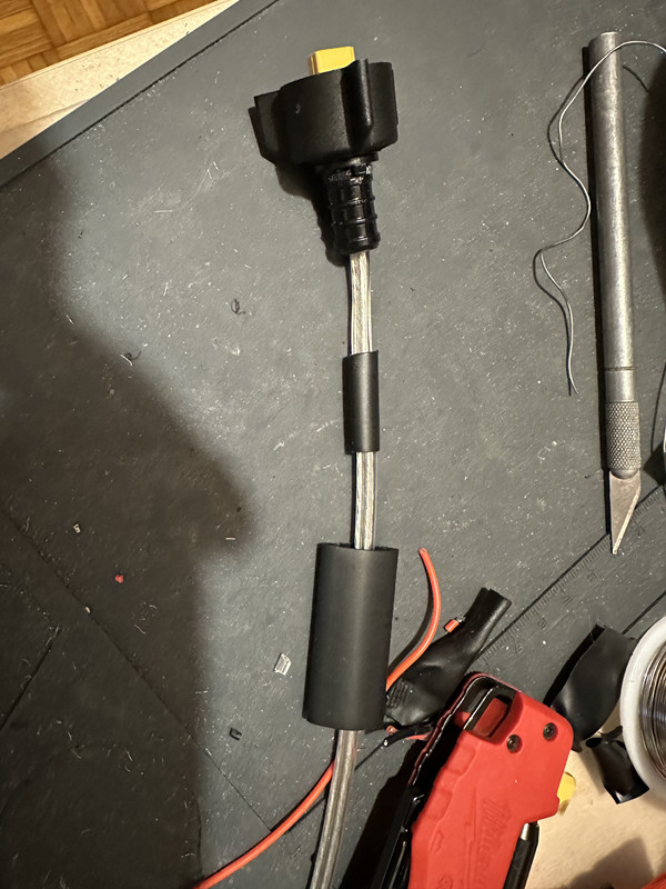

Reinsert the connector into the fitting, threading the long length of wire through the barb (MAKE SURE IT'S FULLY INSERTED). With the extension on the connector, it becomes more cumbersome, so before you add the resin slide the pieces of adhesive lined heat shrink onto the cable from the bare end.

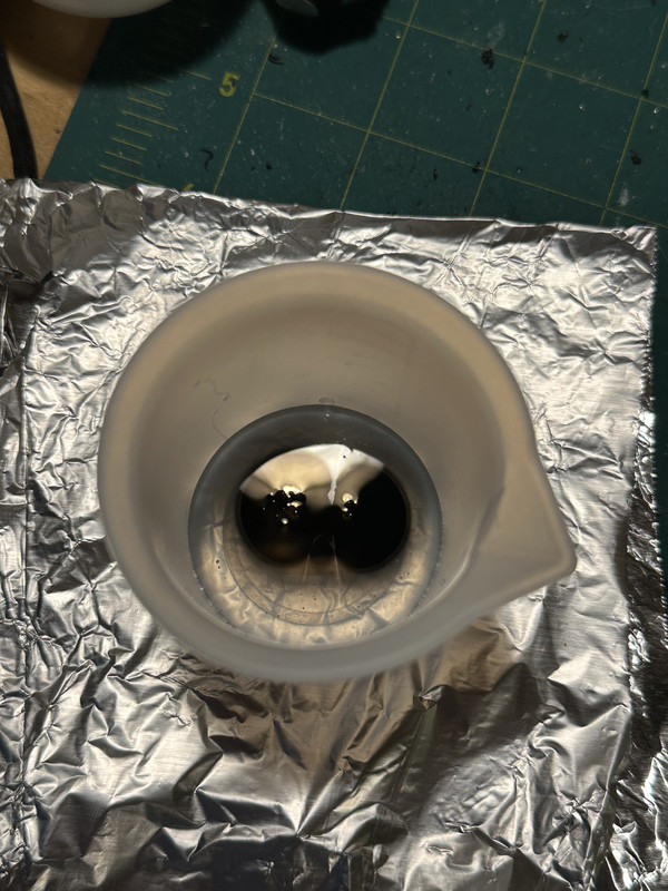

Step 8, prepare your workspace for resin. I used a random craft grade 2 part epoxy resin from amazon. I believe genuinely almost anything would work, so feel free to experiment depending on your budget. The stuff I used seemed to be just about perfect but I'd reckon the thinner you can get, the better. You can probably do a pair of connectors comfortably with between 5-10ml of resin, TOTAL. I made 20 and was left with a huge ridiculous puck of resin. This is another area that requires more experimentation. I also added black pigment to mine, but this step is optional.
Step 9 is to fill the connectors with resin, starting from the outer end of the barb.
I used a cheap dropper that came with the resin kit, but the resin was too viscous to really use effectively. I'd probably get a real syringe and metal applicator needle when I do this again. NOTE, the male adapter end can just sit on the table as the XT30 is recessed inside the fitting, but the female swivel adapter will need to be held in a vise or clamp as the connector extends out past the fitting.
You want to fill each end with resin until they're topped up. I agitated the resin with an oscillating saw but in hindsight I'd recommend not messing with it at all beyond tapping it. This part is important, and it's also a little experimental and will vary, but I'd wait 60 seconds after potting the fitting before proceeding to the next side, because we want to let the fitting fully be penetrated by resin before we seal the other end. If you leave it too long, resin will start to seep out the other end, which while is a great indicator you've got full resin penetration, it is messy and could cause the connection to not fit. I luckily was able to save mine when this happened, but in the future you should definitely seal it up and flip it before this happens.
Sealing just involves installing the smaller pieces of heat shrink to build up enough thickness on the wires, then install the larger tube around the barb and wires/tubing. The glue should seal any resin from escaping out (and hopefully some water coming in)
DON'T CONNECT THEM AT THIS POINT, this image is only meant to demonstrate how the heat shrink is installed. The left fitting is the inner hull version while the right is the external end.

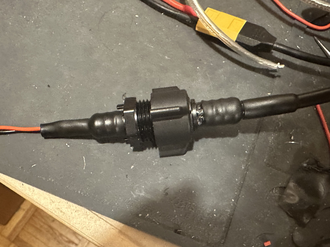

That's pretty much it. The male end can be inserted through a hull and epoxied in place acting as a port that the female end can screw into. I haven't yet pressure tested these, so use at your own risk, but I've had some submerged for 48 hours with no moisture indication on either the inside of the XT30 connector itself or the inside of the fittings. If you're paying attention, you may notice that the connectors have multiple, redundant sealing points. The wire insulation, multiple layers of heat shrink tubing and hot glue, the resin itself, the shielded nature of the connector (as well as the screw pressure forcing the connector closed, and then of course the same layers repeated for the other cable end. This just means that there are a lot of checkpoints for water to get blocked off by, meaning if a seal fails, damage will hopefully be minimized.
I also verified that there no shorts, nor non-trivial resistance in the connections, which there were not, and this means the connectors are fully and correctly seated. I wanted to visually inspect this to make sure though, so I sacrificed a set of connectors to double check. Any damage or marks on the connector are a result of my reckless dremeling, but if you look closely you can see the seam where the two connectors mate, and they're fully inserted.
You can also see how the rubber gasket seals the swivel fitting onto the male adapter.
