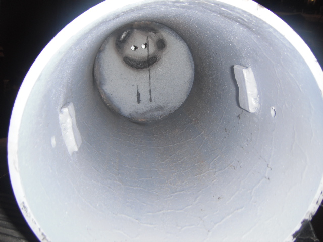

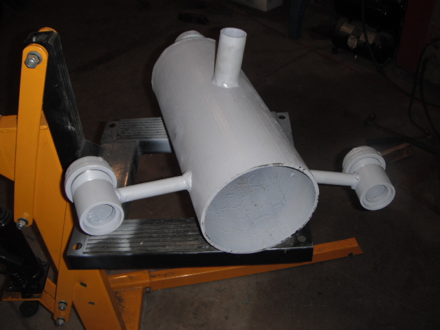

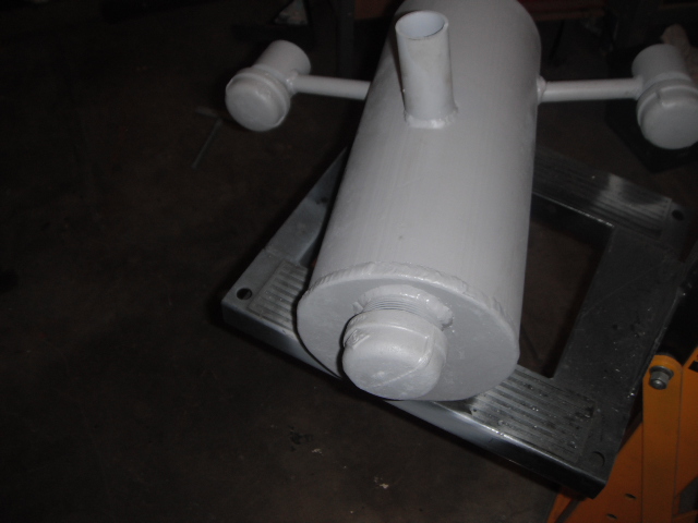

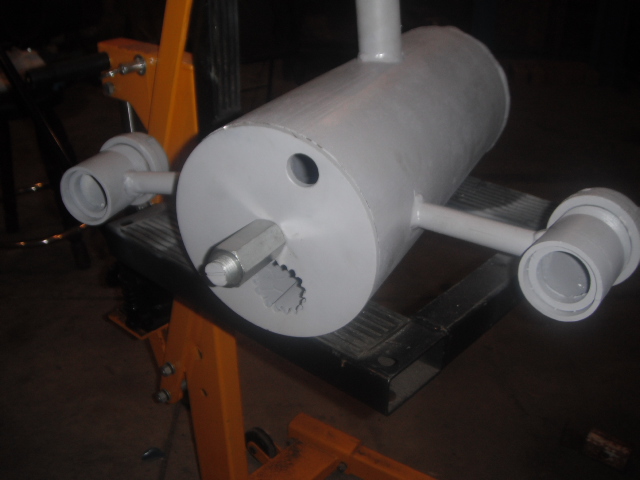

Here is my first ROV project. Hoping to be able to reach 500'. Every thing is slowly coming together. Heres a few pics of where Im at now in the contruction phase.
- DSCF1272.JPG (185.34 KiB) Viewed 12414 times
- DSCF1270.JPG (190.28 KiB) Viewed 12414 times
- DSCF1268.JPG (196.89 KiB) Viewed 12414 times
- DSCF1267.JPG (198.8 KiB) Viewed 12414 times
- DSCF1266.JPG (197.1 KiB) Viewed 12414 times
- DSCF1265.JPG (187.67 KiB) Viewed 12414 times
- DSCF1264.JPG (190.49 KiB) Viewed 12414 times
- DSCF1261.JPG (190.35 KiB) Viewed 12414 times
- DSCF1260.JPG (196.44 KiB) Viewed 12414 times
greenkarson
- Posts: 36
- Joined: Jun 5th, 2011, 9:21 pm
Re: deep ROV
The ROV will have two motorcycle style 12 volt batteries onboard. The 2 holes in the back cap are for leads for charging the batteries with out having to remove everything to get at them. Just open the front plate to let the batteries vent during the charging process. The inner collar in the head light is to hold the lexan. Which will be epoxyed into place. There will be lexan over the two camera windows as well. The bigger hole is for the cctv live feed camera and the offset window is for the hd video camera that will be recording.
