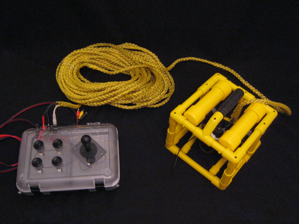

Re: making cat5 neutrally buoyant
I'm pretty sure it's 3/8", (while I did test it with just the cat 5) my tether consist of the cat5 (minus the outer covering, a A/V camera Cable, and 2 16 gauge wires, so I'm pretty sure that all fit in the 3/8" rope. While it may not float it does act as a good strength member and keeps everything in a nice neat package. (so to speak)
